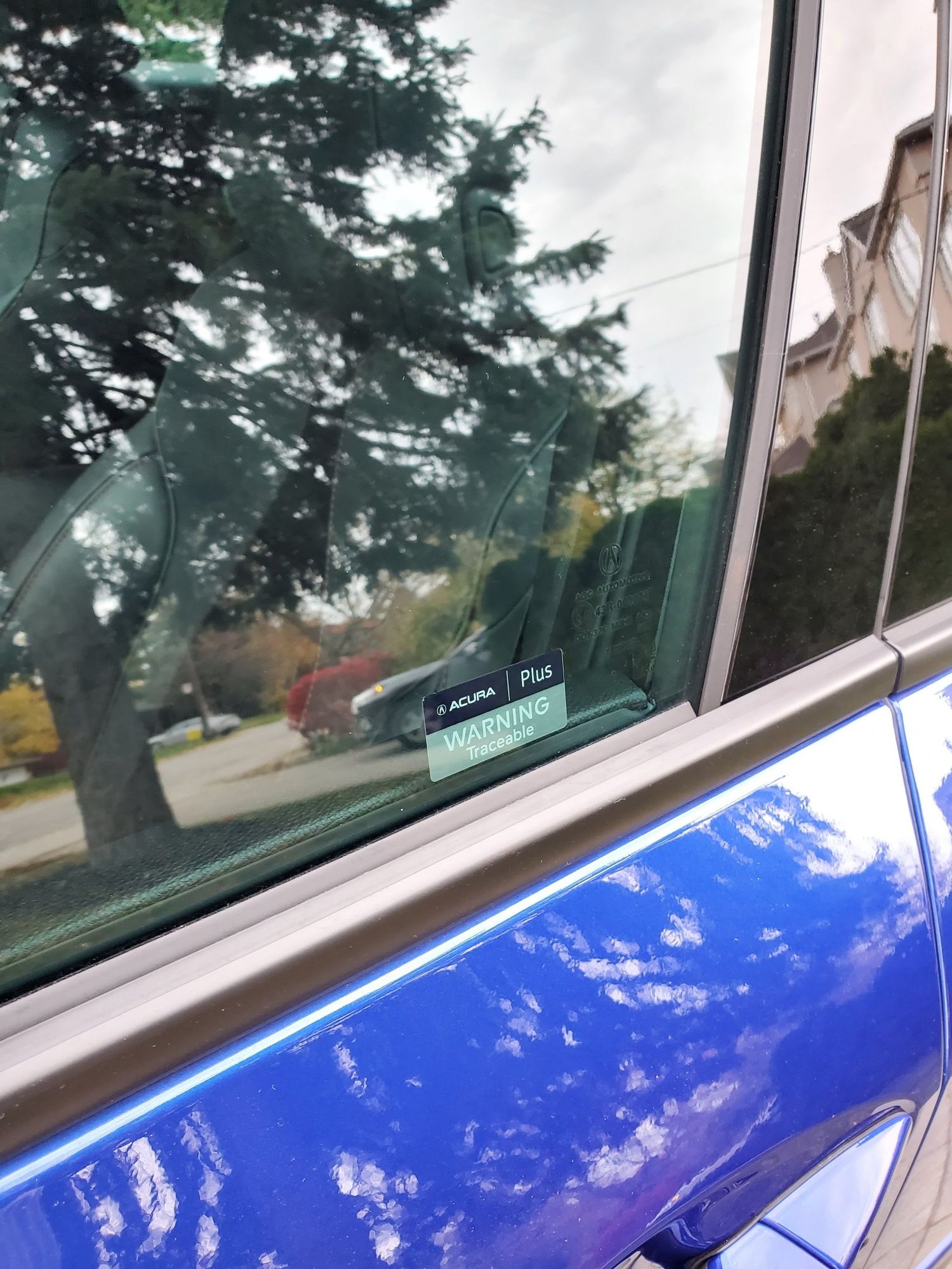

My insurance company contacted me stating the TLX Type S was deemed a "high-theft risk" and there will be a $500 per year surcharge starting 2025 if I don't get an approved tracking device installed. They said trackers like AcuraLink & Apple Air Tag are not approved as sufficient tracking devices.
They did say however that Acura Plus Locate is approved so that's what I had installed. The service advisor at Acura said pretty much all the Canadian insurance companies are doing this for the TLX Type S...
