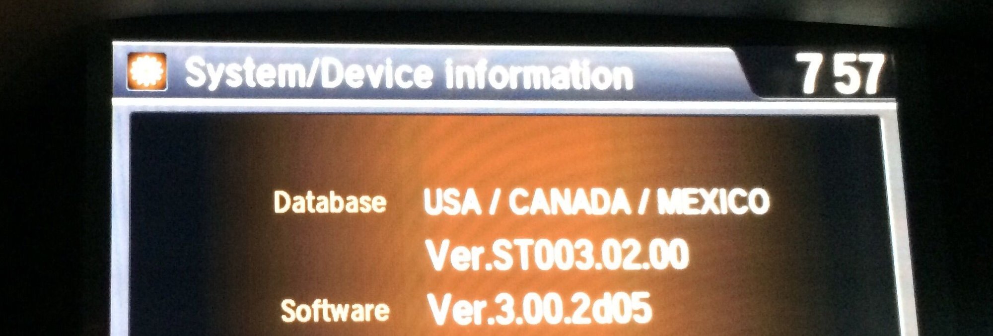

DCT Updates
Well it's been over 3 weeks since I did the latest software update and the clutch break-in procedure. Its still behaving very good with no lurching or delays. Now the 8spd DCT feels like a good transmission. Finally!
Unfortunately, my dealer wouldn't do anything for me and disavowed knowledge of any update. Guess I'll be writing a letter to Acura Customer Relations.

I called my service adviser today for the recently released TSB. I was told that it is merely an official release of the software back in Feb. He told me there is no need to update again. Can anyone verify this is true?
Ask him if they did the clutch break in procedure twice back in feb as that is part of the TSB.
So..I guess it's wait and see right now with my car. I met with Service Manager regarding my trans "bump/kick" when stopping. Nice guy. Appreciated the time he took with me.
The recent TSB does not cover my VIN (build date 3/15 and VIN FA017). They hooked the car up, and the system indicated car does not need to be updated at this time.
Since they have no been able to replicate the issue, we decided to escalate the issue to the District Rep and see if it happens again in the mean time. If it does, I will let the dealer know.
Would appear to me, that the 3/15 build is not the same software version that is shipping as an update, but since my VIN is out of range, cannot get update done unless dealer can replicate. Frustrating, but I also understand where the dealer is coming from at this point.

Does anyone know what software version is it showing?
I got the latest update in april 3rd week. I still notice some jerks and lurching. So, i just want to know which software version my car has? Any help is very much appreciated. Thanks.
