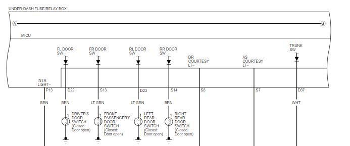

If the shock sensor is the type that triggers the alarm by GROUNDING the circuit...you can use this for reference. You will want to the sensor to ground one of the door switches at the fuse box. This will trigger the alarm.
