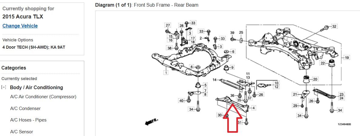

Sorry, I think I am looking for the wrong parts. I finally got to see the bottom of my car and there are these 2 threaded holes. Do you know what are they for?

@zackkit
Since it appears you have an all wheel drive TLX, my best guess is the below?
#4 on the diagram below, front sub frame stiffener?
Though, I'm not sure if it would fit over the exhaust from the angle of the picture.
Make sure to update this thread if you find joy.

This is it! Thanks!!!
