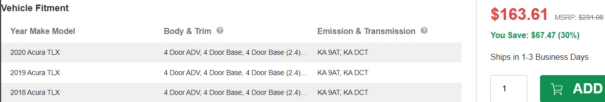

The 'catalog' you are referencing is incorrect in terms of the TLX model year range.
74120-TZ3-A12:
74120-TZ3-A11:
The TLX model year range for the 'A11' hood latch is 2015-2017 not 2015-2018 as you state above in your original post.
Originally Posted by merycoolz
Does anyone know the difference between these locks?
As far as what the 'specific' physical differences are between the two, who knows?
Not having one of each in front of me for actual examination makes it difficult to speculate upon; however, the difference can't be that large.
If you mistakenly purchased a 74120-TZ3-A11 for a 2015-2017 TLX and have it in hand, install it on the 2018 radiator core support and see if you can make it work.
