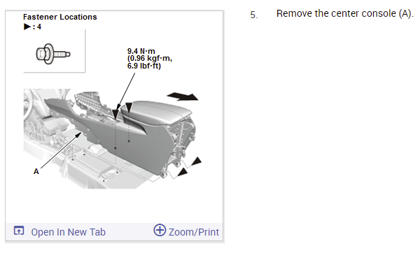

Does anyone have instructions or a tutorial on how to remove the wireless charging unit on a 2019 Acura TLX A-Spec?

1. Remove the rear vents form the center console
2. Remove the side panels
3. Remove the center console
4. Remove the center pocket
5. Flip the pocket over and remove the wireless charge pad

Thank you so much! That is perfect!
