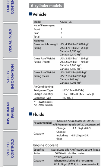

Looking at the fluid capacities above for the SH-AWD V6 TLX, if they needed 10 quarts of 08200-9017 ATF-Type 3.0 for a '3X3', that would be $305.30 just for ATF.
$694.70 seems high just for the labor end.
