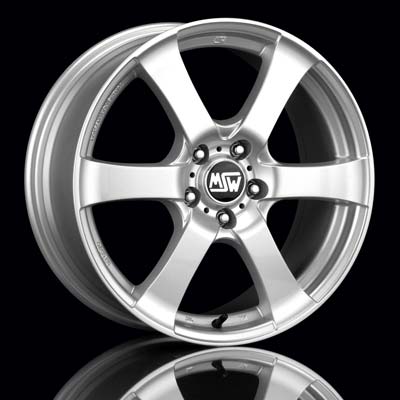

I bought these for my wifes 2010 SH-AWD with Blizzaks. The 17" wheels are the smallest you can go and yes the 17" OEM wheels wil fit as well.
Car is a tank in the snow.
http://www.scottmarlow.net/images/ms...s_ci3_l_1_.jpg
