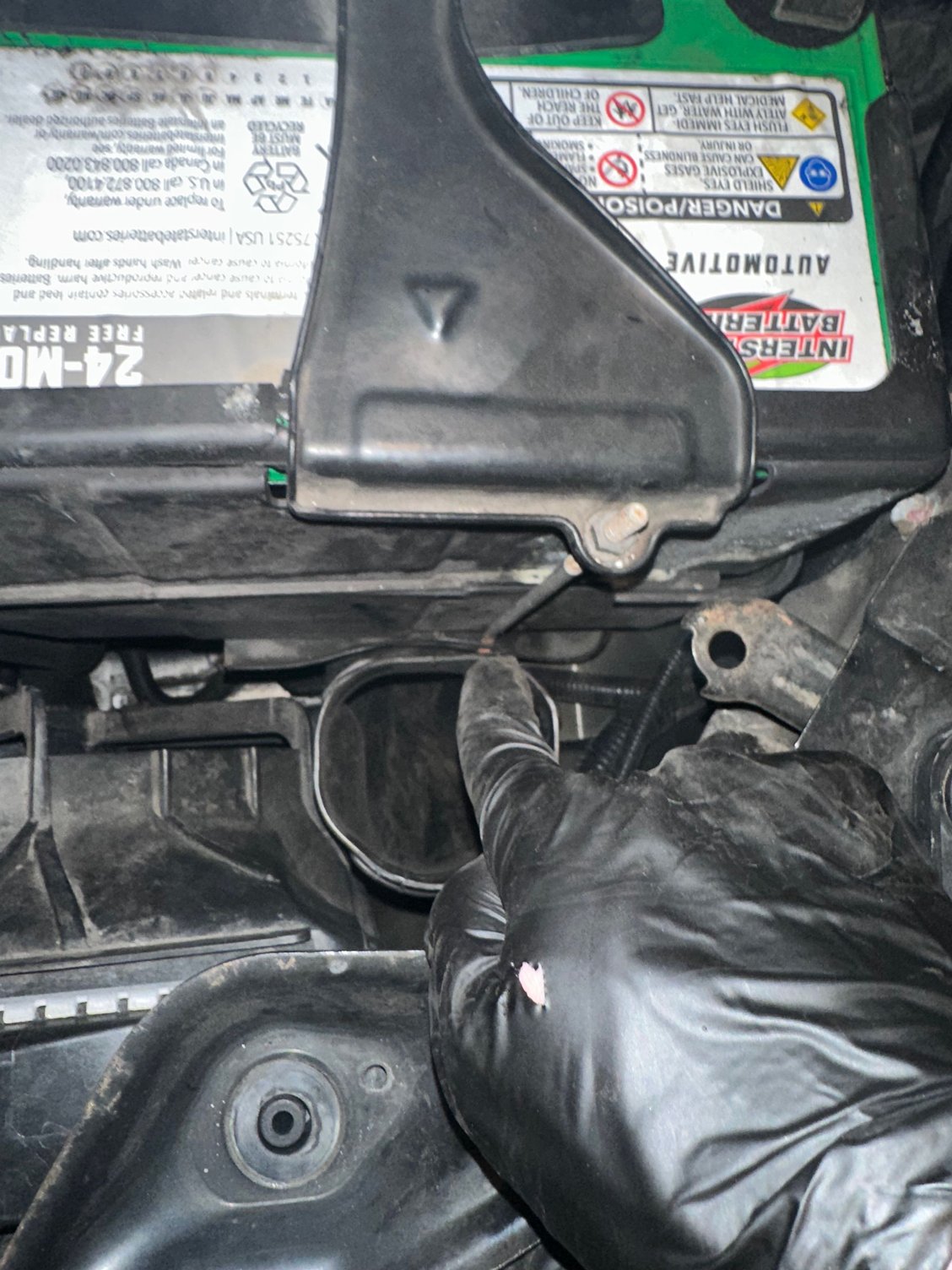

Just finished double checking the work, all bolts are tightened to spec with no signs of movement (bay is filthy, would be quite easy to see scrape marks), no glaring points of contact related to the mounts.
however, did notice the resonator chamber is a bit loose, not sure if this is normal or if it’s usually tight in place. Also seems to be making direct contact with the long metal screw/piece that holds the battery housing in place.
On the other side of the battery housing, there is a very small point of contact to the airbox. I tried reseating the airbox in hopes to correct positioning to no avail, contact point still there. Will be attached in next comment.
here is video showing airbox to battery housing contact
