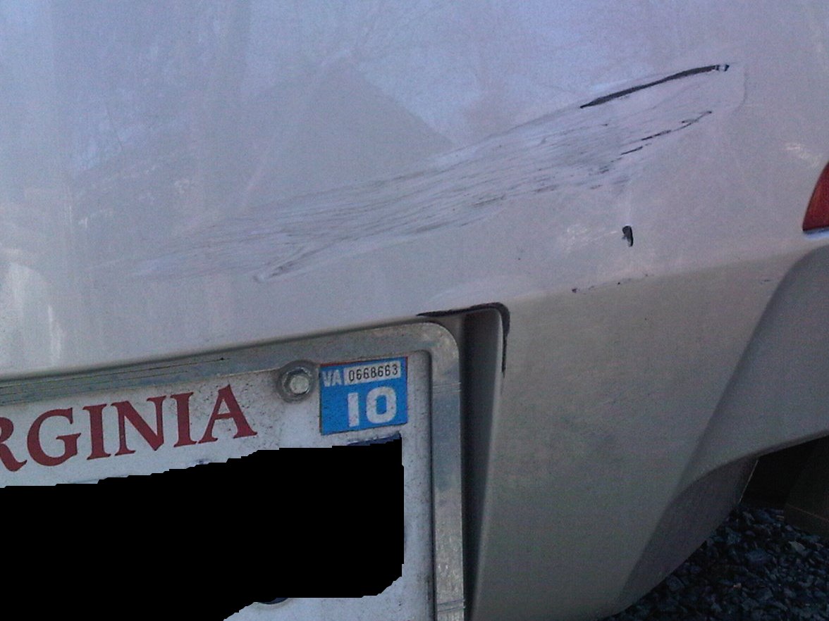

Someone made this overnight onto my 1month old baby.
Anyone knows which is the best way to cover this up?
Or please suggest anyone who could do this around Northern VA?
Thanks

Couldn't see the picture.
Old Jan 5, 2010 | 04:03 PM
calisimon's Avatar
Joined: Dec 2009
Posts: 11
scratch on the rear bumper, size of a palm? not severe(no dent) one though

calisimon,
Now that I see this, you can bring it to a body shop and they can buff, paint, and blend but it won't be cheap. It will look like factory. If you want to do it yourself, first use wax and/or some swirl remover and get as much of the marks off as possible. You'll be surprised at how much of that is really on top of the paint and can be buffed out. The parts that can't, you can touch up with some touch up paint.
Certainly it won't be as pretty or near original as if a body shop does it but it will cost far less, almost $0 if you have the wax and swirl removed lying around. And, if you really can't live with the do it yourself, you can always bring it to a shop later. In other words, nothing you do now with the wax and touch up paint will make it worse for a body shop, should you go that route later.
BTW, sorry that it happened, especially when the car is so new. I would have had a fit!
I agree. A similar thing happened to the front bumper of my last car. I buffed most of it out and used a bit of touch up paint to minimize the scratches and gouges. I didn't want to put much $ into a bumper repair since I often use public lots and street parking.
