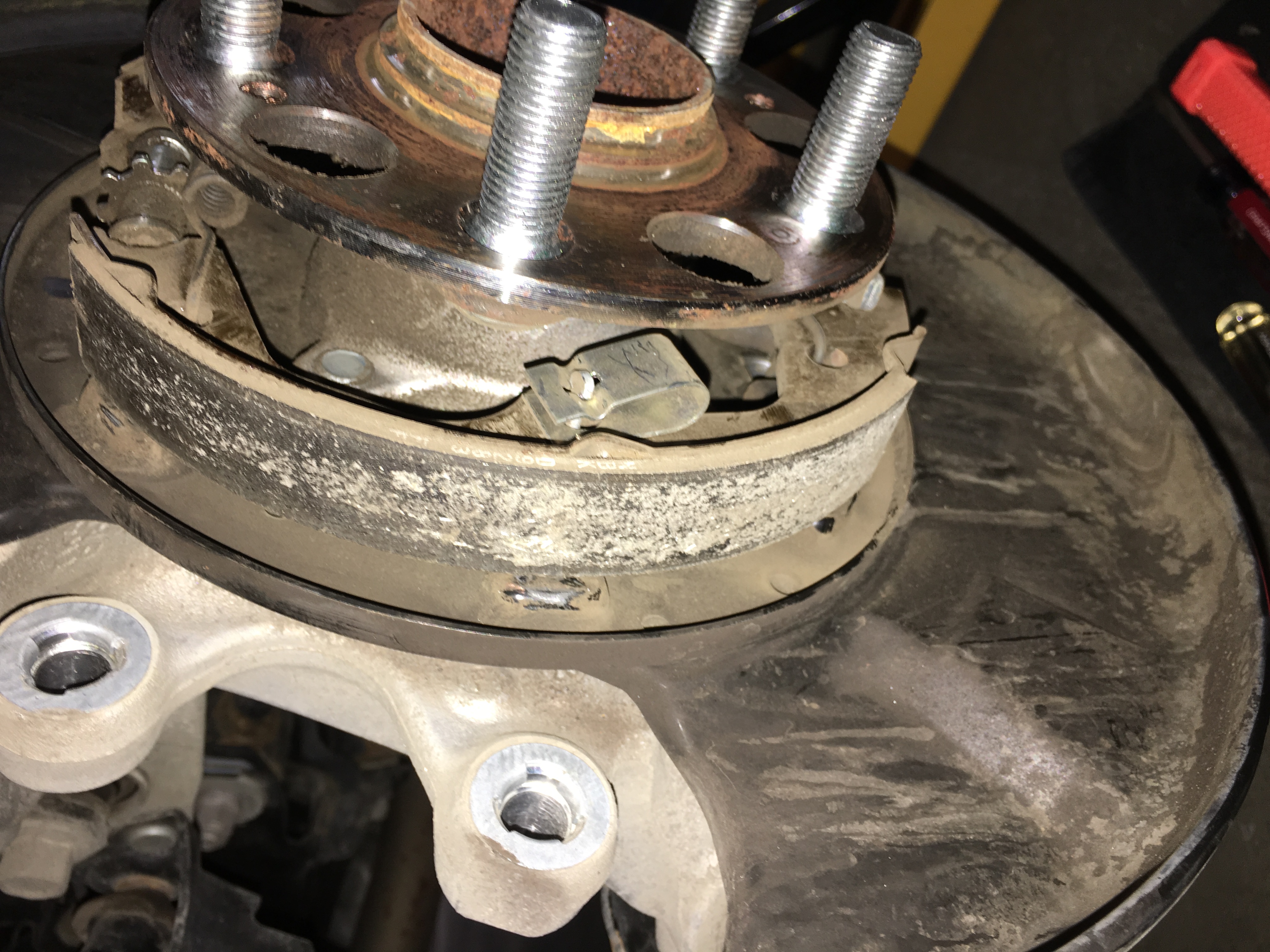

Here is the culprit. One of the shoes was adhered to the rotor drum.

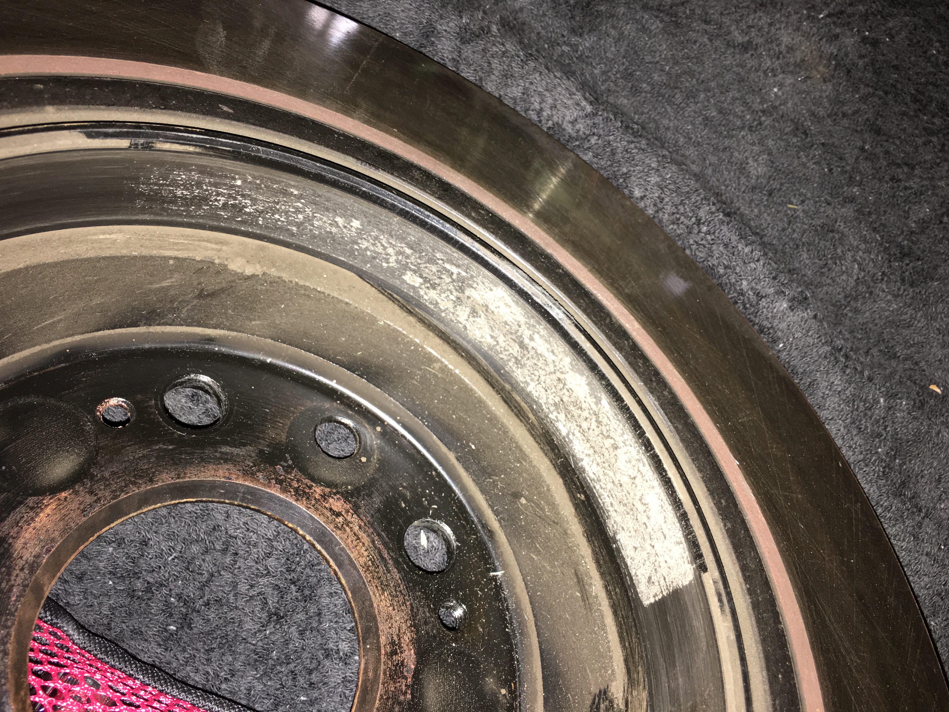

Here is the rotor

The garage I park in has a slope to it. I always set the parking brake. It adhered like this after being parked for one work day. Nothing unusual except the rain yesterday morning. These brakes had not seen any substantial rain or snow over the 3,000 miles they have been on there up until yesterday. I have not personally seen a brake shoe adhere to a drum in this manner under normal, regular use.
It's loose now and the car is drivable. I will replace the shoes and clean up the drum in the next few days.

did you adjust the rear parking brake after putting on the new rotors 3K miles ago? If not, they could have been contacting the whole time and allowing a layer of pad material to transfer and melt eventually causing the whole thing to stick.

The new rotors I installed have a black coating on the I.D. of the rotors. I think the coating may have been applied to the braking surface for the parking shoes. I don't know for sure, but I had to sand off quite a bit of something from both sides to get down to bare metal.
