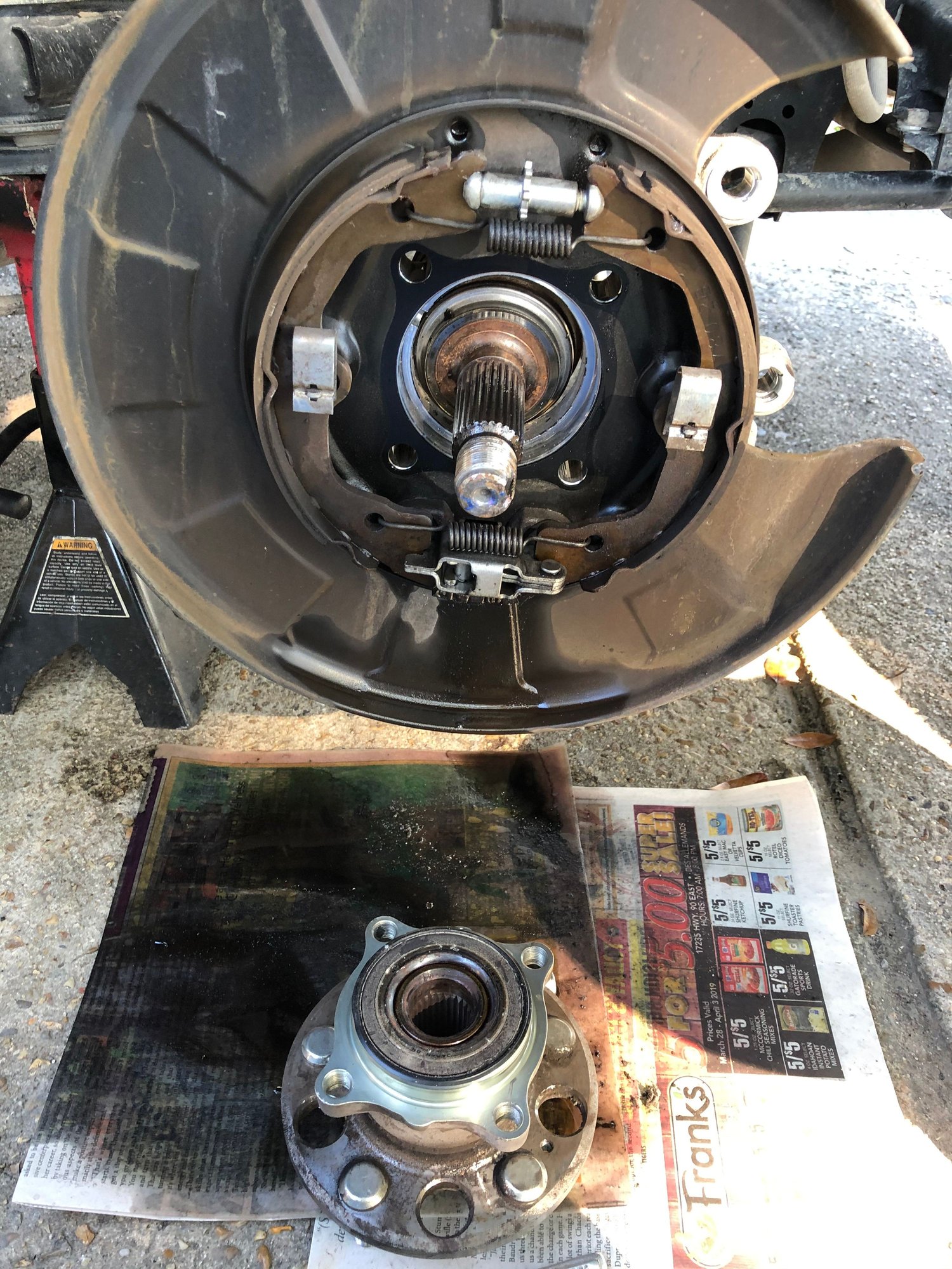

Reorge's Avatar
Posts: 831
Likes: 188
From: New Orleans, LA
Yes, it's fairly easy to replace because it bolts on.
I had to replace my rear driver wheel bearing last month. (~140K miles)
Noise was getting progressively louder over a 2-3 month period.
I have SH-AWD so the process was a little move involved than a FWD.
I used a Timken part because is utilized a NTN bearing which has provided excellent service life in my professional engineering designs.
I also used Timken on my daughter's TSX 6 months ago and no problems.
With wheel still installed and socket through wheel center hole, I couldn't remove the axle nut with a long breaker bar (SH-AWD only).
I fired up the air compressor and used my impact wrench to remove nut.
The liquid in the attached pic is brake cleaning fluid.
Wheel bearing assy (Timken): https://www.rockauto.com/en/catalog/...+assembly,1636
New Axle Nut rear (Beck/Arnley): https://www.rockauto.com/en/catalog/...indle+nut,1616

My bearing wasn't loose (wheel didn't move).
It made a noise that was starting to drown-out the radio.
The noise also changed pitch based on car speed.
