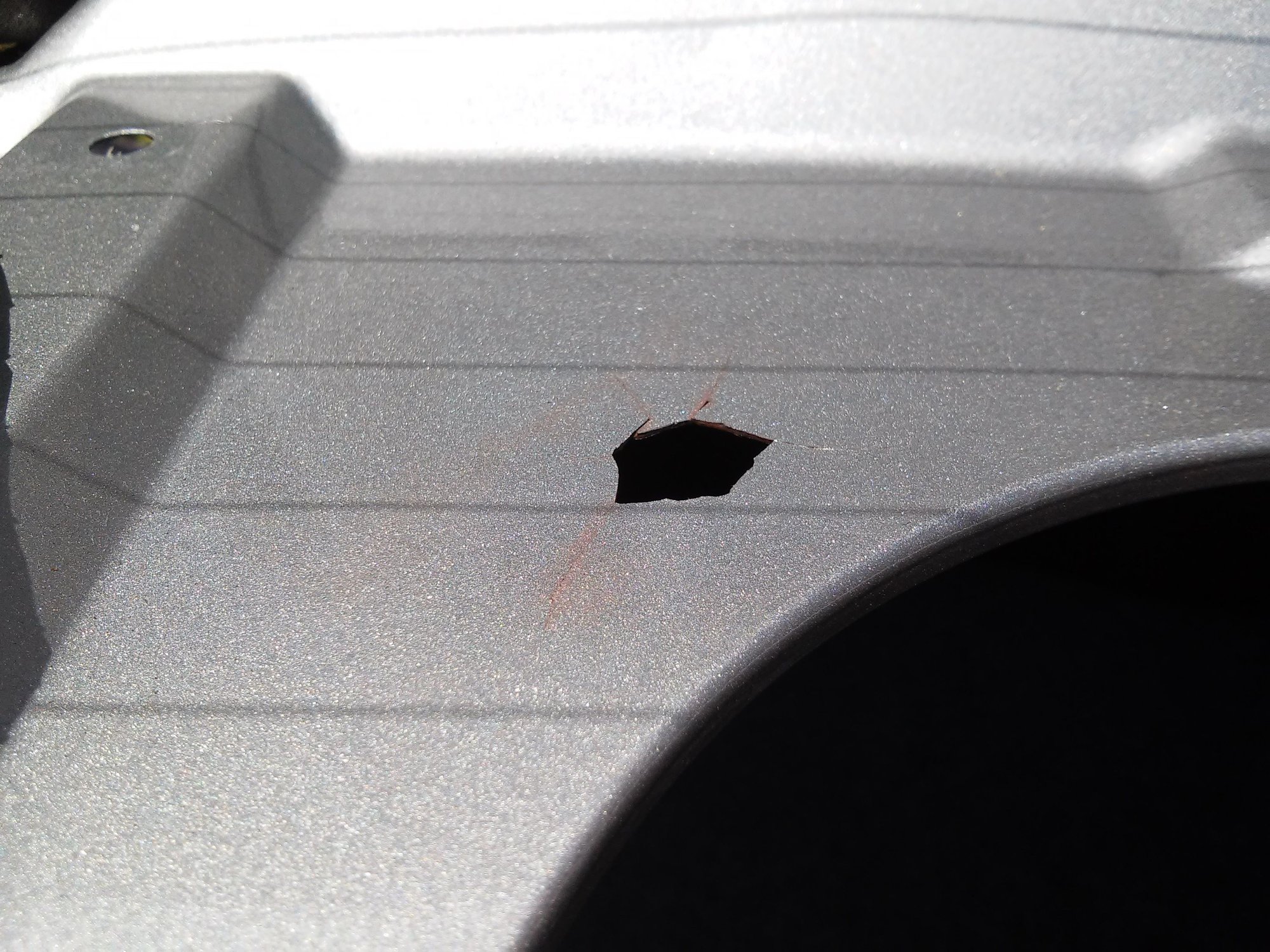

I Dynamatted the rear deck yesterday and my hopes are high. I used the Dynamat Superlite followed by the Dynamat Dynaliner. I'll post a picture in the next day or so. Since the back seat is out, I plan on Dynamatting some areas behind and under the seat as well. The Superlite is very thin and the Dynaliner compresses very well, so it looks like there won't be any problems with the fasteners being able to grab the sheet metal fully.
Oh, and I found the cause of my rattle--cracks in the sheet metal surrounding the subwoofer mounting holes. I removed the sub, Dynamatted over the area and will be applying JB weld from the underside to prevent the cracks from spreading (per the TSB).
