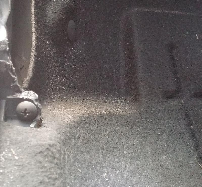

I just moved mine back a bit and now I'm fine...
Before:
After:

^ Exactly what I am looking for! Thanks!
