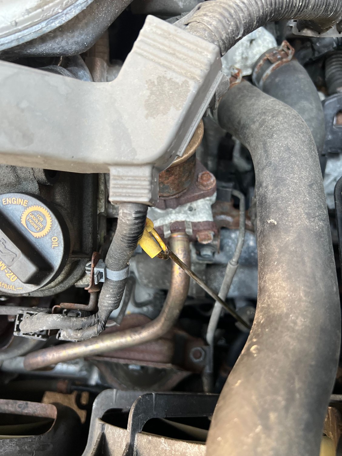

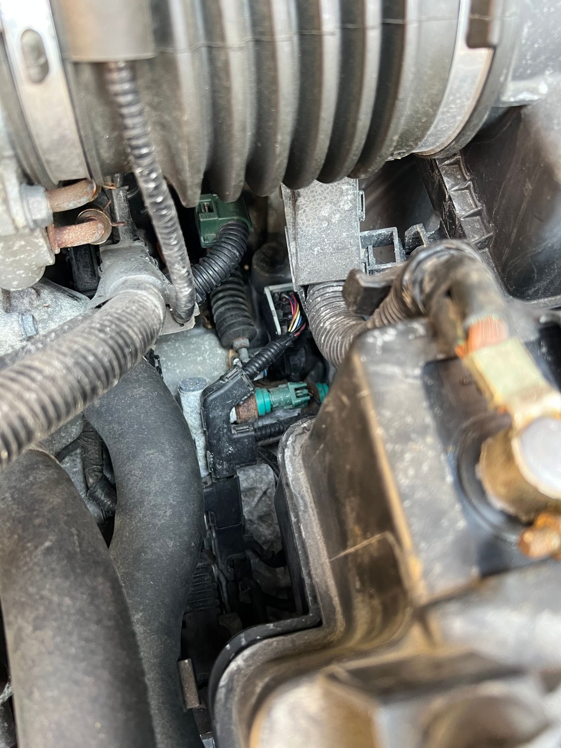

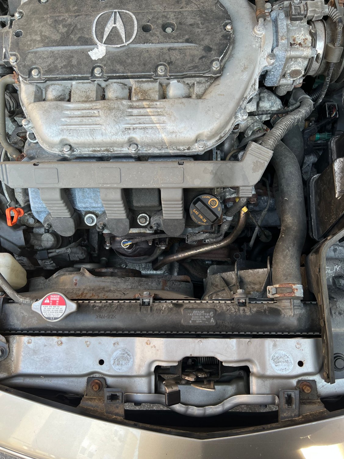

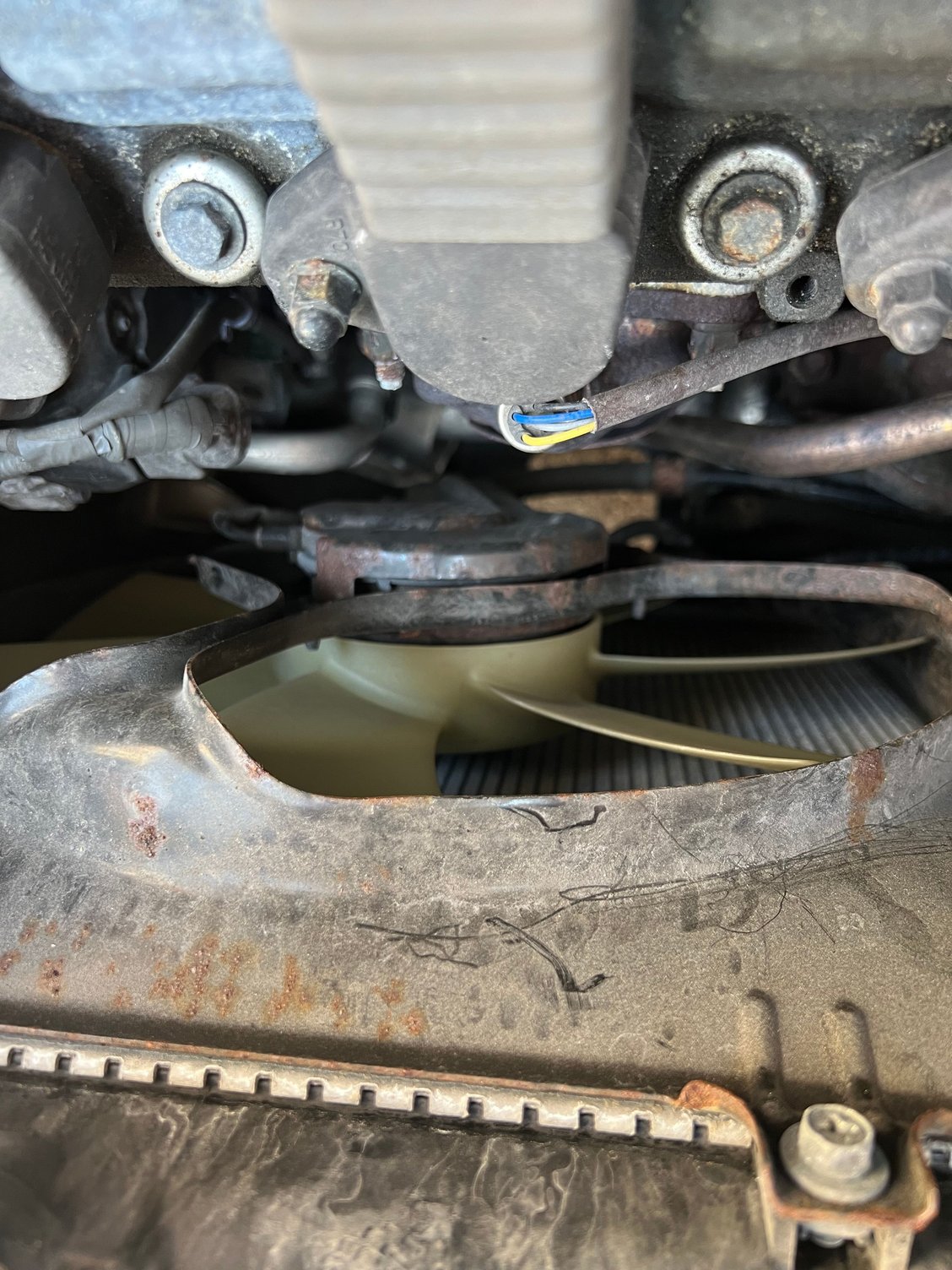

Question about a new to me 2012 Acura TL. The car was owned in NJ and has 87k miles on it, apparently owned by an older gentleman per the dealer. I recently bought this and decided to do some basic maintenance on it like replacing air filters, checking coolant, etc. I was trying to open up the air intake compartment and noticed two screws were impossible to remove and if I proceeded, I would risk stripping it. So I started spiraling and inspecting the engine bay and saw rust. It's a 2012 car so rust and debris is to be expected but is this amount of rust normal? I tried to capture some of the debris but it looked like organic matter interspersed. It also didn't help when someone I know told me he took a look at the engine and it looks rebuilt lol. I am sorry for the dumb question and just freaking out but I just need a sanity check. Thank you guys for all of your help!

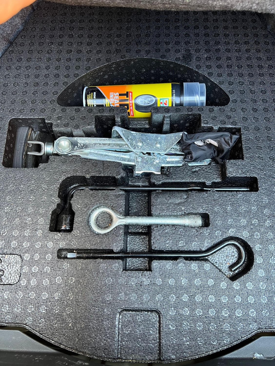

White spots on the scissor jack, I would assume it's just normal corrosion?

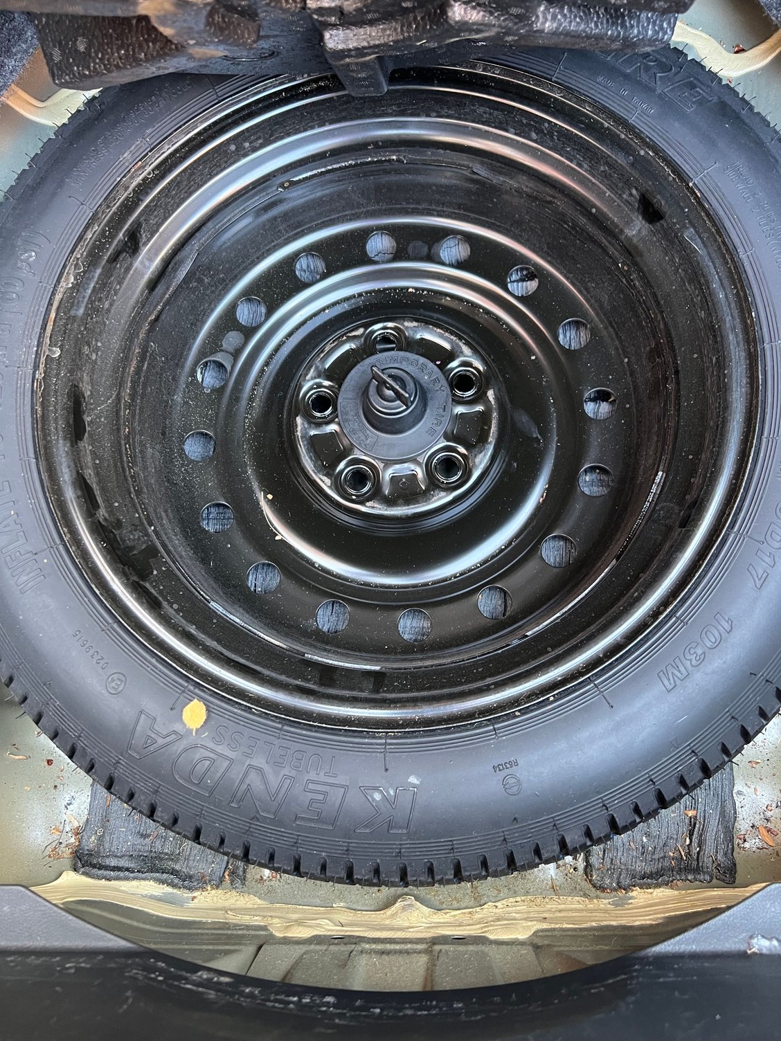

Does this compartment look normal? There's some cobwebs and some debris in here too.
Not sure what this green band is when removing the trunk liner on top of the spare tire compartment.

I'm thinking that car has spent a lot of it's life in a very moist climate or near the ocean (or both). Could also be road salt related.
I have a 2012 with 100K miles and she still looks pretty decent under the hood, only a tiny bit of surface rust here and there on bare metal parts.

If it's only superficial surface rust, you could work on those parts with a wire brush or steel wool for the sensitive parts. With a little time and effort, you could clean up nicely. A clean rag and some diluted Simple Green would work wonders on the grunge. Just be careful near wire harnesses, they can become brittle on their old age.
As for the rebuild, it's hard to really know. It actually seems too dirty to have experienced that, you'd see more clean spots from hands/rags and general clean up activities.

Spare tire well looks pretty normal. But the under the hood area looks like it was exposed to the elements for awhile, maybe sitting outside with the hood up? Perhaps it was parked near a salt water location, as suggested above.

I think it may have sat too! Maybe and hopefully not with the hood up but it could be that it was near the coast of NJ and Florida. But thanks for the confirmation that the spare tire well looks normal. Is it normal to have debris there and the sort of bondo/pasty looking part towards the rear of the spare tire compartment?

Yes, bondo/plastic sealant is normal, my TL has the same material in the spare tire well. Well appears dry, you would definitely know if it was holding water from a trunk leak, etc.

Yes, that bondo-looking material is OEM. If it's parked outside, leaves/debris will gather in the front of the seal at the trunk cavity, below the rear window. When the trunk gets opened, some of that debris will fall in. Mine is not often parked outside, but we have an Accord with a similar design that does. Periodically, I have to vacuum leaves/dirt/twigs out of the trunk. Sometimes that stuff can fall down into the spare tire well.
