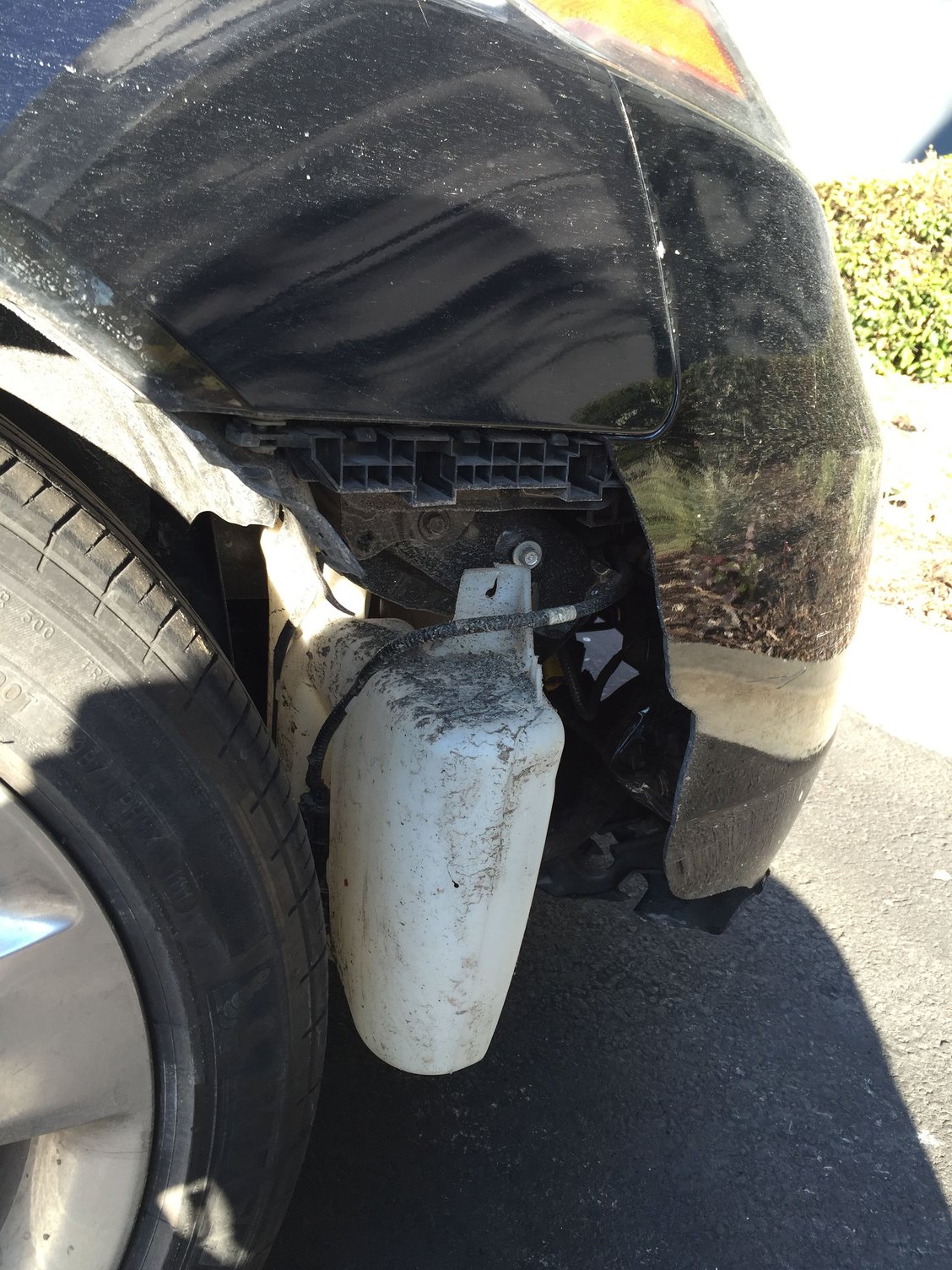

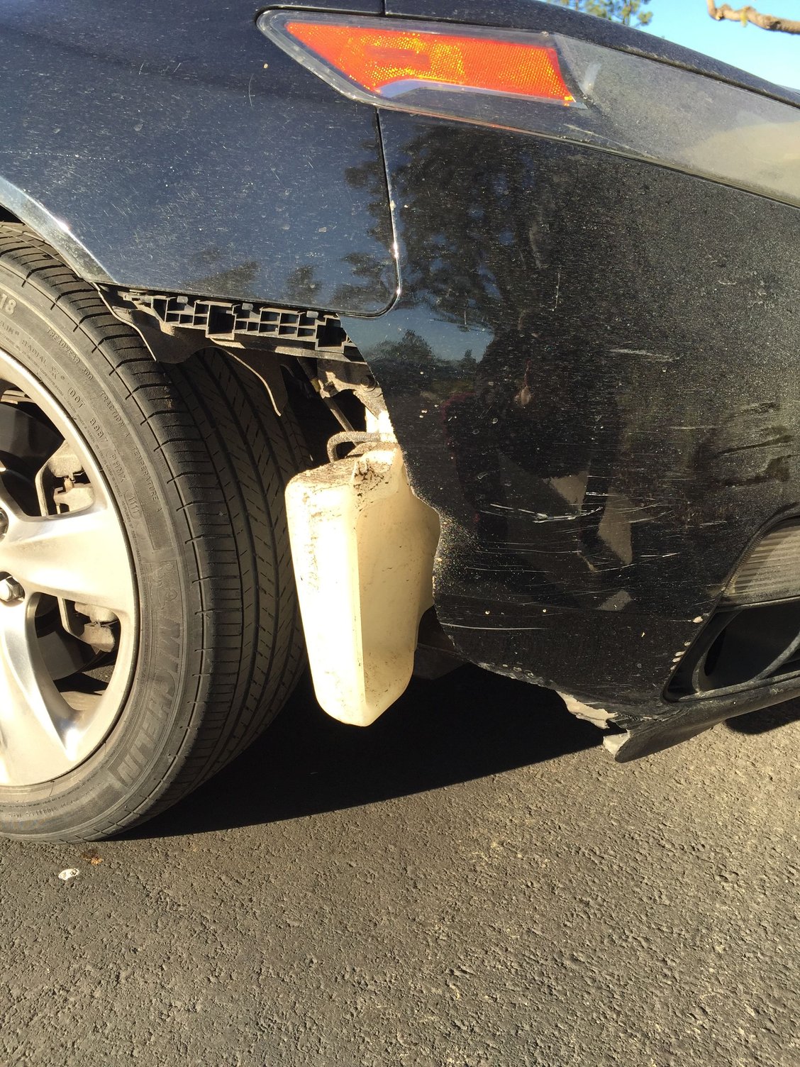

I was driving Yosemite and on the downhill, my car slipped little bit and hit a piled snow and this happened.
If I want to get the part to replace the bumper which part do I need?
Do I just need the front bumper face or is there something else I need?
I need you guys help so I don't overpay to fix it. It is 2012 TL AWD Tech
It was amazing to drive the uphill with the AWD handling without the snow chain. I just drove too fast on the downhill.
Thank you in advance.

Looks like you need to replace front bumper, right fender splash shield, and possibly the center splash shield.
Look underneath to see if center splash shield is still there or damaged.

you'll need the inner fender as well.. and thats $41.84
and any missing hardware; ie, screws, clips, bolts.

in this pic, it looks like windshield washer fluid reservoir has been pushed back slightly and ripped the mounting point....
not a really big deal, BUTT be sure to check other components and make sure they are still in factory spot

if you are still driving it i would reattach the wiper fluid reservoir or remove it until getting the car fixed so that motion does not drag it off prevent more cost

I dont think it's going any where. I just pointed it out to let the OP know that OTHER components MIGHT be out of whack....
more important components that might impede driving.
the reservoir is not going any where as its bolted along the neck...

Good point, but I think the reservoir is dead too. The mounting bracket is ripped through.
