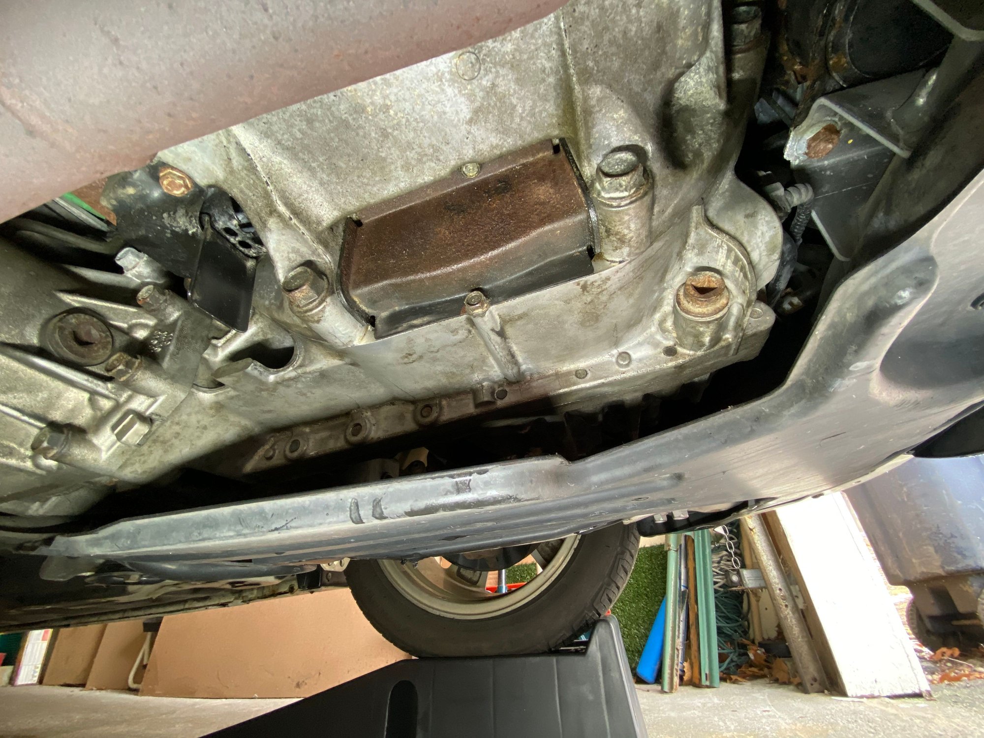

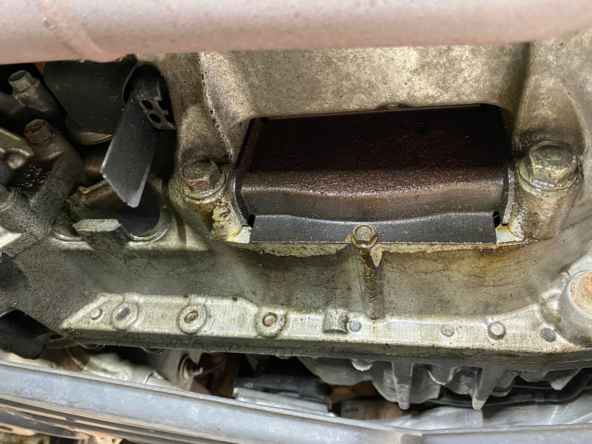

So I got the car from my daughter.
While changing oil I took some pictures of underside.
The leak does not look serious.
I used break cleaner and cleaned up all underside.
I will see by next oil change how bad is the leak.
Attached some pictures of before/after cleanup.
Before cleanup
Before cleanup
Before cleanup
Before cleanup
After cleanup
After cleanup.

That is a nice TL for a great price! Congratulations. That leak doesn't look bad at all, just run some high mileage oil and see if it stops. There are also some sealers you can pour in if it gets worse.

Thanks, I cleaned it up back in December and did not see any leak since.
I will check again in sprint time.
