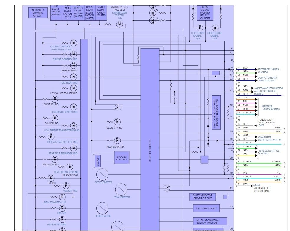

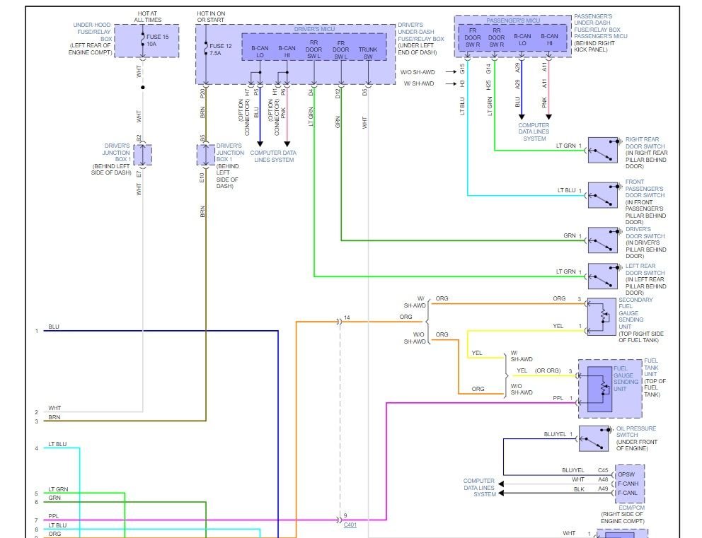

You have 2 powers and 2 grounds, if they are ok, then buy a donor and swap the parts.
