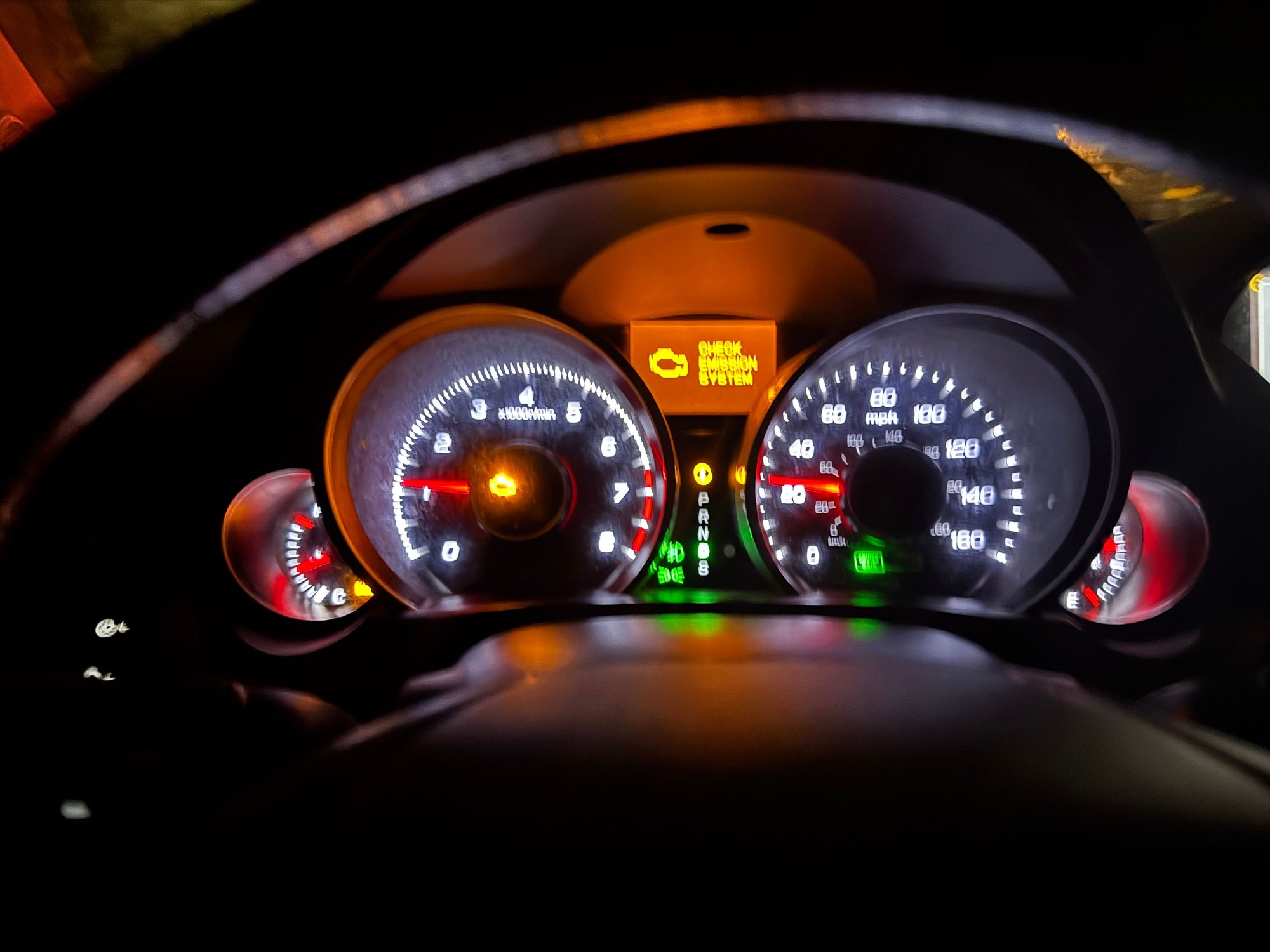

Hello everyone. I have a 2012 TL with the J37. I’ve only had it for a month now and I have some problems…
It’s burning oil and has a good amount of valve noise… I’m hoping putting 3/4 10w and 1/4 liquid molly or something equivalent might help. thoughts?
Another thing is the codes. It gets the awd light and i know it’s actually not working since it’s snowing over here at the moment. It also gets a couple evap/emission codes. I’ve noticed the gas mileage is terrible. I’ve had an odyssey with the j35 and there’s no way it ever gets 6-7 mpg. Fuel Cap wire is snapped idk if that has anything to do with it. The codes come and go.
Im putting pictures of the codes the cars showing.. I know some people say it’s the purge valve etc. but i just want to make sure before i buy anything.
Any help would be greatly appreciated.

Hopefully it is just something simple. I had the "tighten fuel cap" issue last year and looking into it turned up two separate evap system leaks. These cars are just getting old now.
I got lucky I changed the fuel cap and for right now the evap codes aren’t coming back after I reset it. Hopefully it was just fuming out from there.
