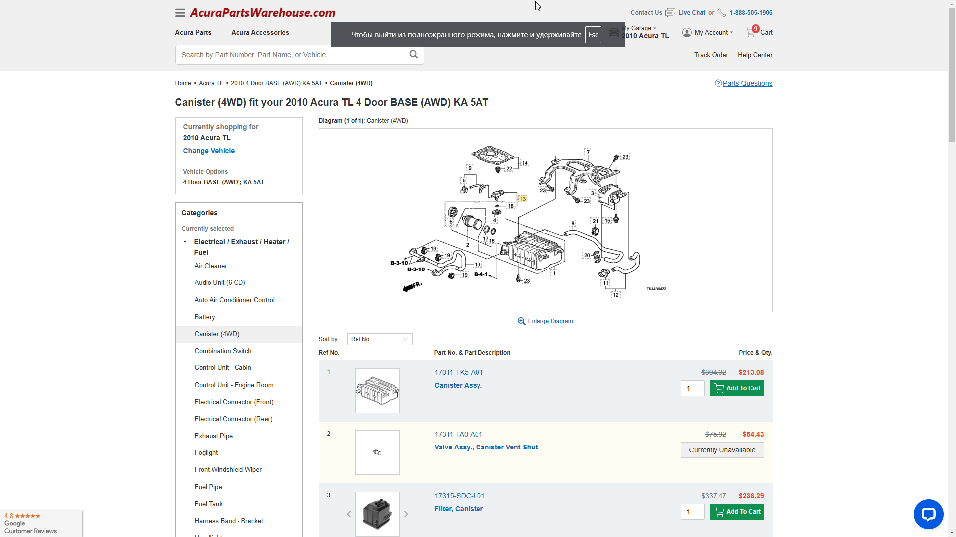

The above issue is still happening.

It seems to be a Fuel Tank Pressure Sensor problem.
The dealer did an EVAP test and has determined that to be the issue.
I have had Emission System: P145C and P1454 earlier this month.
I brought the car to them Feb 7.
According to the dealer, the Fuel Tank Pressure Sensor on this car is located near the Charcoal Canister. It is not easy to get to.
It would require the rear axle to be dropped again. He said the tank needs to be removed and the rear subframe needs to be taken apart.
The service is recommending not to do this work because of extreme cost and to just drive as is.
Can anyone confirm the location of the Fuel Tank Pressure Sensor on a 2010 TL.

Yes, you need to remove the rear subframe.
