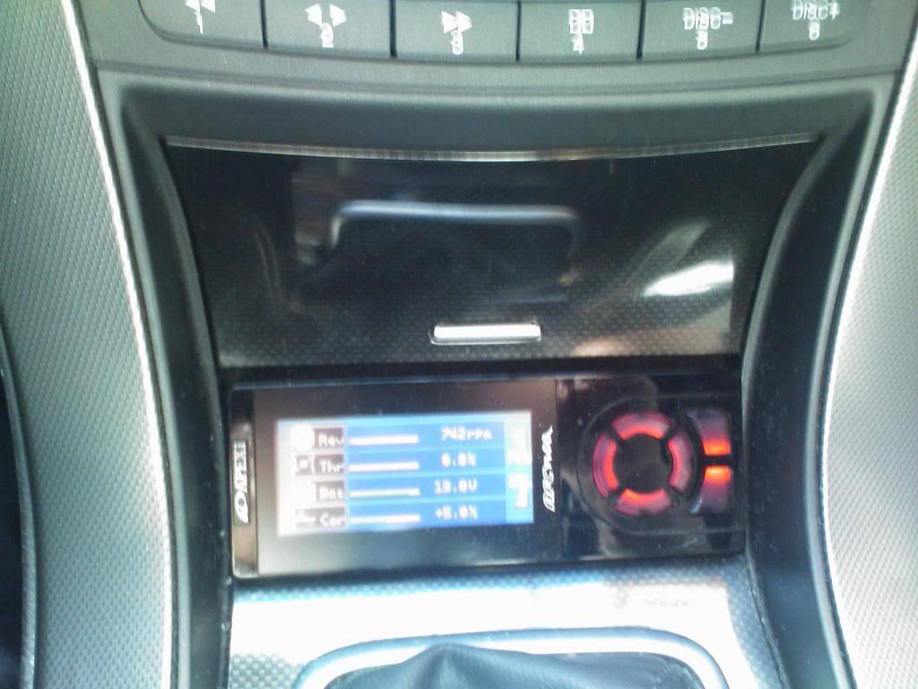

Here is a pic of a 3g type s corrected with apexi
Old Oct 13, 2014 | 12:02 PM
4GTLSH-AWD's Avatar
Joined: Aug 2014
Posts: 210
From: New Jersey
As u can see the last bar says corrected so its possible and as far as wiring u dont need no harness i seen it done . the pic proves it

In jersey its not like that car was tuned on the neo and ecm had no codes at all passed inspection with no issues at all .. im not saying its a big gain all im saying it help and helps alot

Not a question of if it was done ,was it done on a 4G? and what are the results?
Many on the 3G side feels that this is a waste of time more so now that a proper tune is available for them.
I am just curious about the info you provide and i am not doubting you either, the picture of the 3G installation proves nothing.Many on the 4G side would love to see a proper tune become a reality,i have read about the Boomslang harness but no real proof of performance improvement.
