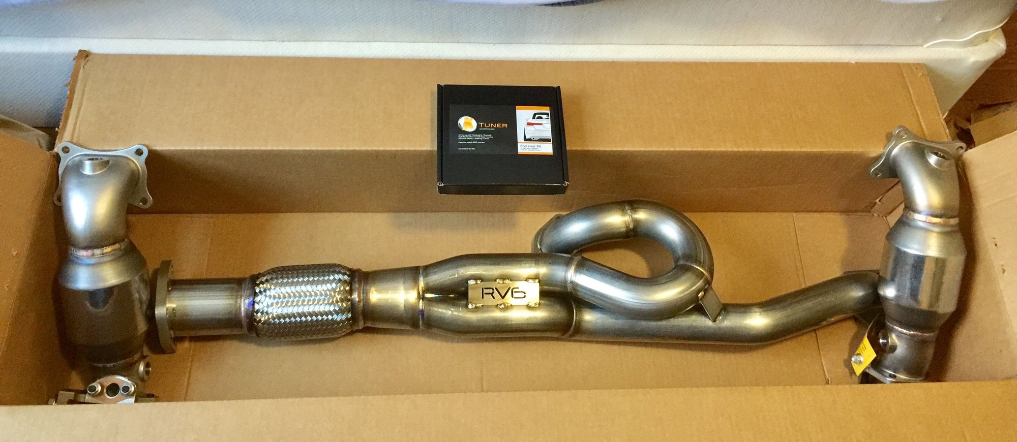

Old Dec 4, 2018 | 02:30 PM
Jrc6MT's Avatar
Joined: Sep 2018
Posts: 29
From: Rhode Island
Christmas has come early! (Although all I can do for now is look at it)
Old Dec 4, 2018 | 04:04 PM
dopeboy1's Avatar
The inconvenient truth
Joined: Apr 2017
Posts: 1,467
Likes: 453
Awesome!!! Make sure to do a review of the difference you notice with the pipes and ktuner. Just pipes first and then once you've added ktuner if you would be so kind haha.
