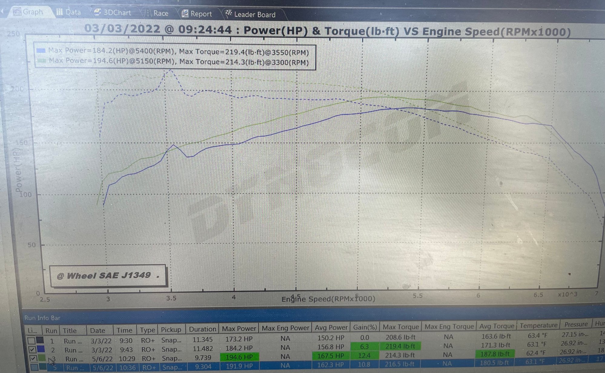

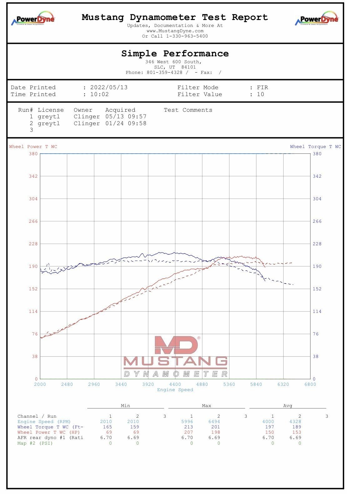

You said the dyno didn't do the final tune justice. Did you have a dyno page from that? Or by custom tune you just mean the ktuner map that you are using?
Old May 30, 2022 | 07:03 PM
  #45
ultrapogi's Avatar
Joined: Mar 2015
Posts: 286
Likes: 77
From: Farmington, UT
I was referring to the custom tune compared to the stock tune. So on this one the stock tune is lower and the custom tune higher. If you go by the Dyno only it would seem the change would be imperceptible subjectively. But as you can see from the Dynocom
the difference between the ktuner basemap#4 compared to custom is 10hp/10tQ across the board plus or minus at parts. So stock ecu tune would be even a greater difference. So that tells me something is funky with the mustang difference. It feels subjectively very apparent driving it on the road.
