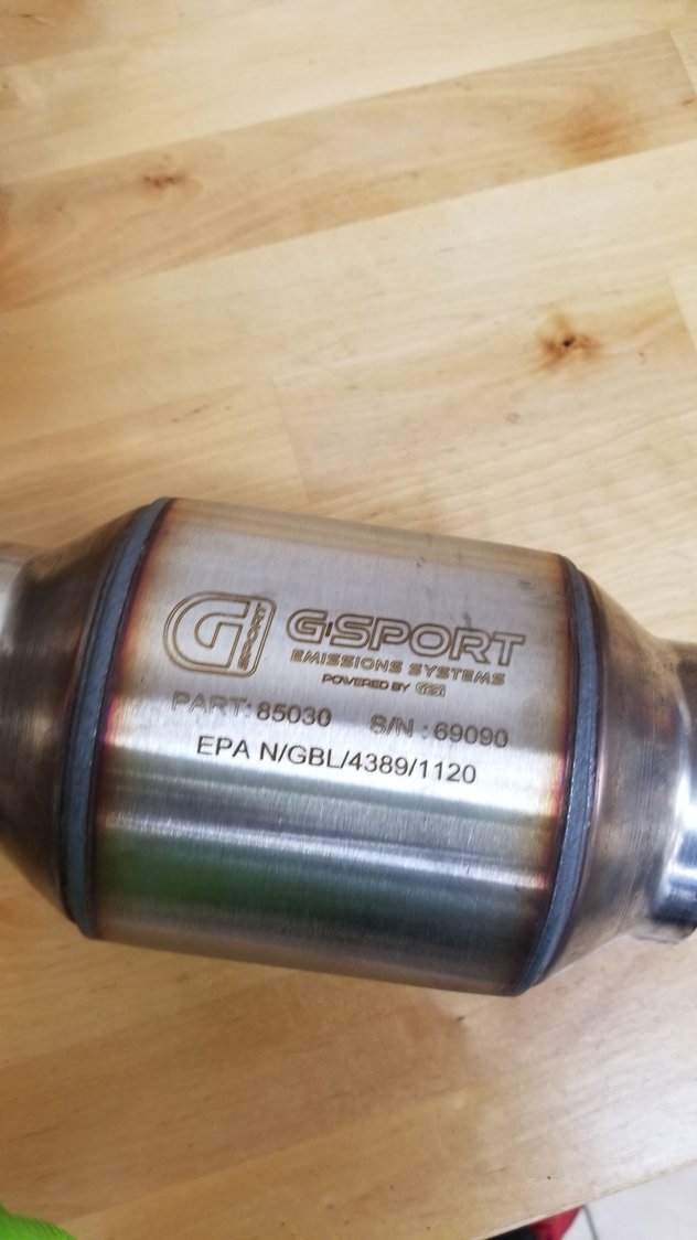

In my opinion no, stock or test pipes is a way to go. These CATS can damage engine. I have no luck with any aftermarket units that is installed close to the engine.
Right now I have high quality GESI/Vibrant cat installed on Jpipe, that kind cat should last a life-time. Also engine makes more power compared to the cats attached to the each bank, and no risk of damaging engine with failed cat.
Old Feb 8, 2022 | 06:46 PM
ultrapogi's Avatar
Joined: Mar 2015
Posts: 286
Likes: 77
From: Farmington, UT
Wow that is a pretty sweet set up. Such a clean looking converter. Now that I have been thinking about it I am wondering if I have some broken pieces in my stock converters. I have had some intermittent rattling sound that I have never been able to identify and I have noticed it the most at idle at stop lights when the car is still warming up. If my stock ones have broken or clogged catalyst that would definitely slow down the flow of exhaust gases.

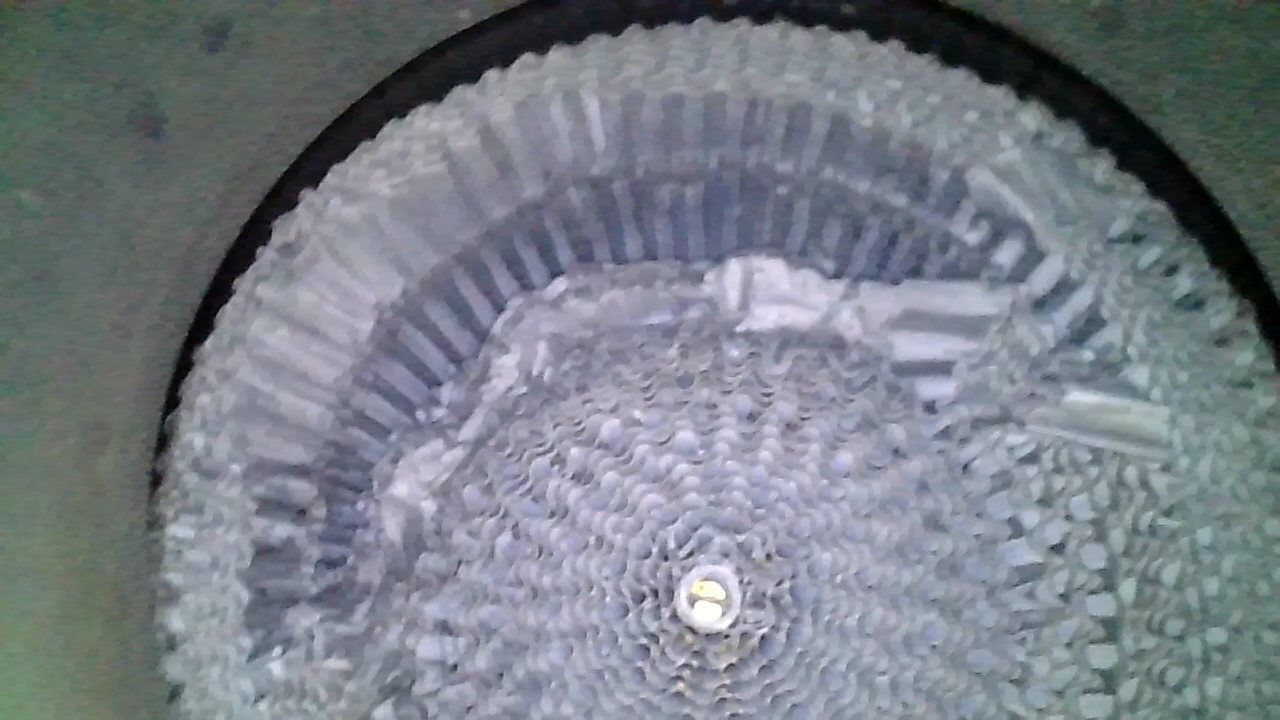

Rattling for first 10-15 seconds during cold start is a classic sign of failed/failing metallic CAT. But since you said you have stock cats, I am not so sure.....
Old Feb 9, 2022 | 10:14 AM
ultrapogi's Avatar
Joined: Mar 2015
Posts: 286
Likes: 77
Maybe I am over thinking things. It doesn’t do it at start. I seem to only notice it a few minutes later when idling. But only when the car is warming up. I have never noticed it anytime else.

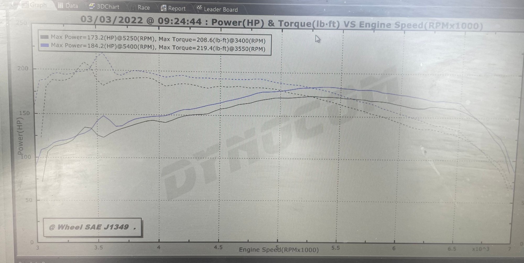

I ended up getting the RV6 High flow cats installed and have another baseline dyno scheduled a week from now on a different dyno. I know it will be apples and oranges comparison because of the different variables but should give me a good idea of where I am now. The addition of the HFPC didn't make my exhaust any louder just some rasp at higher rpms. Not too bad with my windows up. Much better than drone which I hate. Because if i drive conservatively I don't hear it at all only when I get on it and it doesn't bother me. So I will let you know the new dyno numbers in a weeks time
Old Mar 3, 2022 | 12:18 PM
ultrapogi's Avatar
Joined: Mar 2015
Posts: 286
Likes: 77
So good news and bad news. The bad news is the Dyno I did today was even lower than the other one. The graph showing two lines is two different tunes. The lower one is my “in the middle etune”. The larger one is the standard tune by ktuner for HFPC, jpipe and exhaust. The other good news is the Dyno guy today said the graph shows a hump right at the beginning like it wants to make a lot more power but then something pulls it back. So I am not sure if it is timing, afr or something to do with traction control on the Dyno even though he said he turned it off. Thoughts?

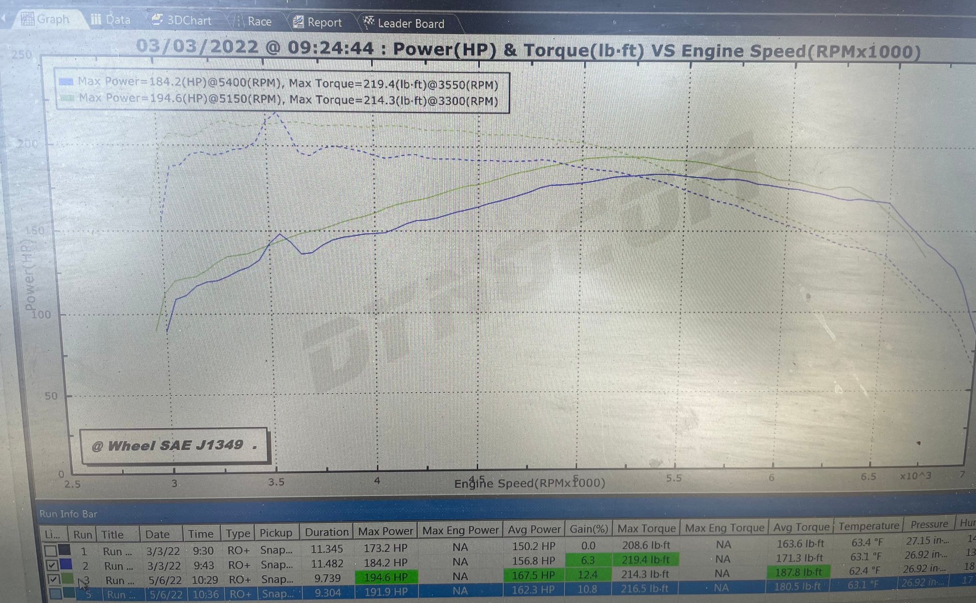

So here is my updated dyno graph. I am still disappointed at the motor. It is weird to me that the torque is higher than the horsepower. It feels good and accelerates well especially if I keep it in the power band above 4K. Also weird that it peaks on horsepower at just over 5K. Would an intake make that big of a difference? The graph is really clean but stock motors make more than me, bummer. The guy did say compared to other dynos like the first one I posted this one reads middle of the line to lower but still that wouldn't make up the big gap that most people are at with these mods.
Old May 6, 2022 | 04:30 PM
ultrapogi's Avatar
Joined: Mar 2015
Posts: 286
Likes: 77
I am going to dyno next week at the other place that uses powerdyne because I was at 200hp and 200tq before the high flow cats and the custom tune. It will be interesting to see the difference. I also picked up some lighter wheels and new tires. They were only about 1.5lbs difference (wheel and tire combo) compared to stock but acceleration is very noticeable. Maybe more of the mass is in the center?? I am getting coil overs soon so I will upload pics once those are on. BUT one thing I did want to point out in this last graph is that the lower line is the K-tuner preloaded map with HFC, Jpipe and exhaust so the custom tune was very much needed. I can definitely tell. The very first run on the DynoCom was the 2nd revision by a different Etuner so big difference without a tune or crappy tune. But looking at the horsepower topping out so quickly it seems like it needs a lot more air up top and is choking out? Is the SRI fairly quiet below Vtec? just in case the girlfriend is in the car with me he he. If it was worth it Derek said the recalibration would only be $250 instead of the normal $450. I really wish I would have gotten a dyno before doing anything just to see how far I have come. oh well
Old May 6, 2022 | 09:04 PM
dzionny_dzionassi's Avatar
Joined: Jun 2010
Posts: 784
Likes: 119
From: willowbrook,il
Something not right, your max HP should be at around 6700rpms and you peak at 5100rpms.
Not sure if it is dyno operator, or technical problems. Maybe bad/dirty MAF, Engine knock, clogged air filter, bad CATS? Or maybe weak fuel pump?How injectors duty cycle % is looking? Ask your tuner. Maybe he sees something out of spec.

You dont think something is wrong with Vtec engaging? I had my cams replaced right before I started this thread by the acura dealership in my area. When I did my last dyno I could hear the exhaust note change so It sounded like Vtec was engaging. I have a dyno scheduled in a few hours at the first place I went to in the first post so It will be interesting to see what that one shows up as. I will post that later today. When I am driving on the freeway the "butt dyno" feels like it continues to pull into the mid 6k range. It doesn't feel like it starts to lose power or slow down after 5K on the road.

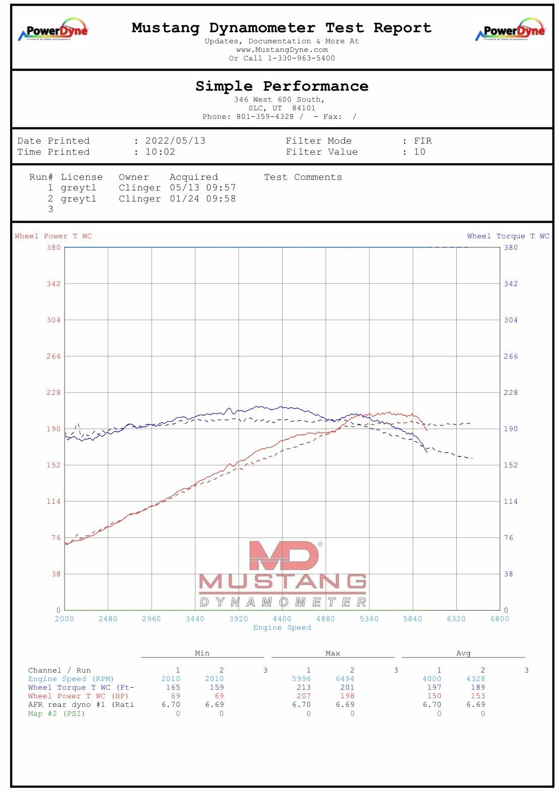

I will post both dynos from both places
Bottom line all the bolt ons. Only difference is bottom is ktuner basemap 4 HFPC, jipipe, exhaust. Top one is custom ktune map
The bottom graph is all bolt ons except HFPC with ktuner basemap 4 HFPC, jpipe and exhaust Top graph added HFPC And custom tune
Some thoughts. I noticed the peak is better on the mustang Dyno but still drops off after 5800Rpm I didn’t want to do a FWD pull because then I would have nothing to compare it too. It is interesting to note the differences seemed greater with the Dynocom graph. The mustang Dyno guy said his Dyno front and back is mechanically linked so they run at the same speed and cannot vary. Both times I did the mustang Dyno my VSA Dashlight turned on afterwords because it probably doesn’t like that the front and rear wheels can’t run at different speeds. Last bit is I really wonder if the HFPC are bad already. I never mentioned this before but I do get a intermittent metallic rattle noise at full throttle when above 5K. Sometimes it is there sometimes not. I heard it again after leaving the Dyno again today. It sounds like a bolt in a tin can bouncing around. I never get a cold start rattle at all. That would really suck if the cats were bad and caused a clog right from the get go.
Subjective feel on the road? It feels better than it ever has. It has gobs of low end around town torque so I don’t feel like I have to wring it out. It feels like it pulls on the freeway at least to 6K. If I am at 75-80 on the freeway and floor it it still climbs and pulls better than it ever has without feeling like it is struggling. Passing power is great. I zip past people like they are standing still. So I am happy with it just a little worried about that intermittent rattle. The very first time I heard it was after a couple 2000-redline pulls while doing the Etune. Then it went away for a couple weeks and now is there only once in a while.

Is it possible that when they replaced my cams back in January that they messed up vtec activating? I drove a bone stock MDX today and I could easily hear the change over. I can’t hear that in my car at all. Is it possible for it not to be activating and not throw a code at all?
Old May 14, 2022 | 02:14 PM
csmeance's Avatar
Posts: 21,420
Likes: 2,188
From: Space Coast, FL

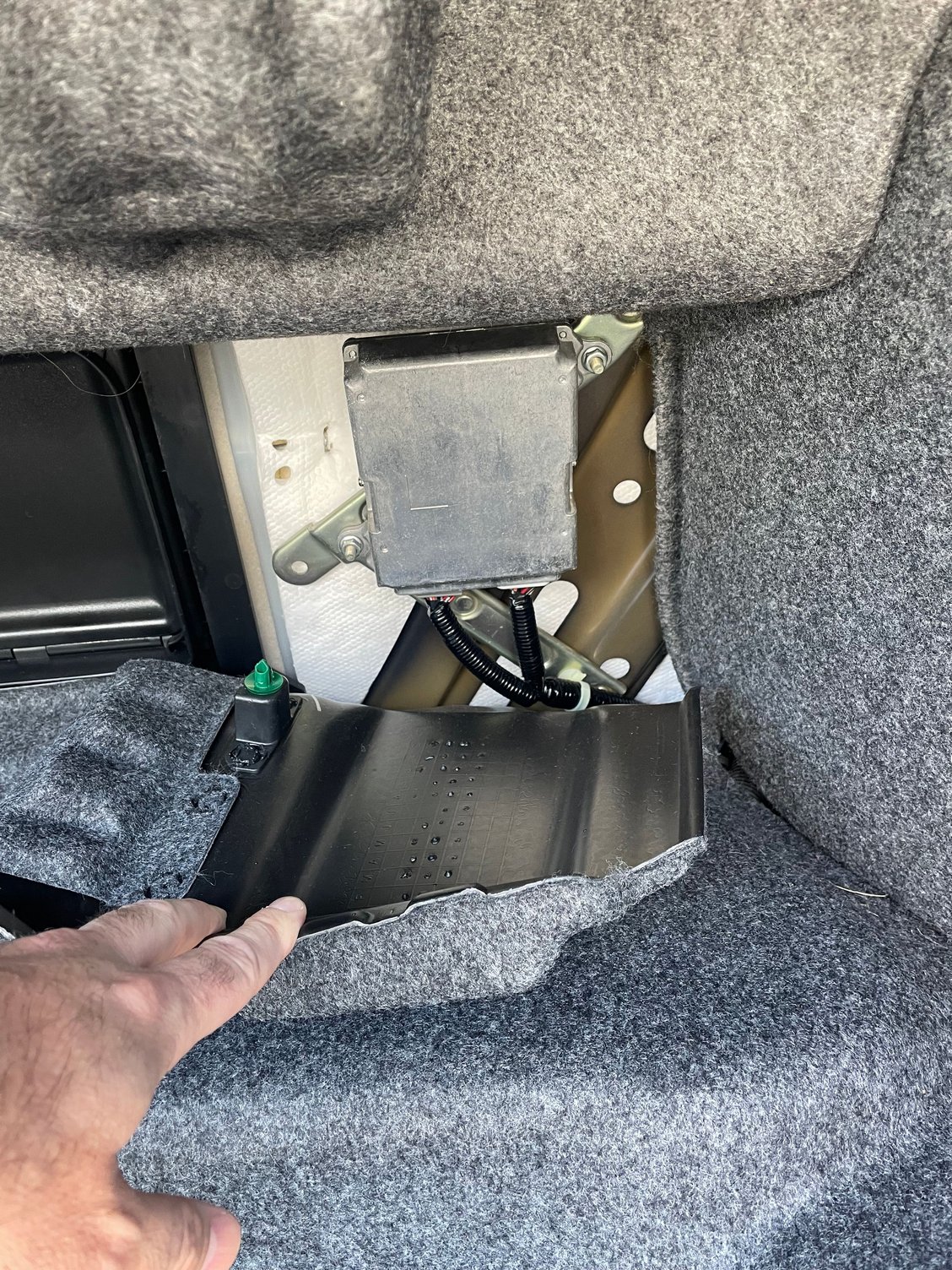

you can pull the wire for the rear wheel speed sensor and it'll shut off VSA, ABS and SH-AWD.
OR this fuse is what I've been told from interior fusebox:
* means if equipped from the guide.
I'd buy some new upstream O2 sensors (NTK brand is OEM) and see if it helps.
Make sure you have the right oil level (not under or overfilled) when on dyno otherwise VTEC will not have enough oil pressure to stay engaged. VTEC is fairly simple system that relies on oil pressure to function properly. With exhaust mods, sometimes it can be hard to hear the changeover.
Did acura do a valve adjustment after putting in the new cams? Side note, there have been quite a few people i know with 3.7L engine that have had the fuel pump randomly take a dump around 100K miles. Check your fuel pressure level, perhaps the engine is being starved of fuel at upper RPMS due to fuel pressure.
