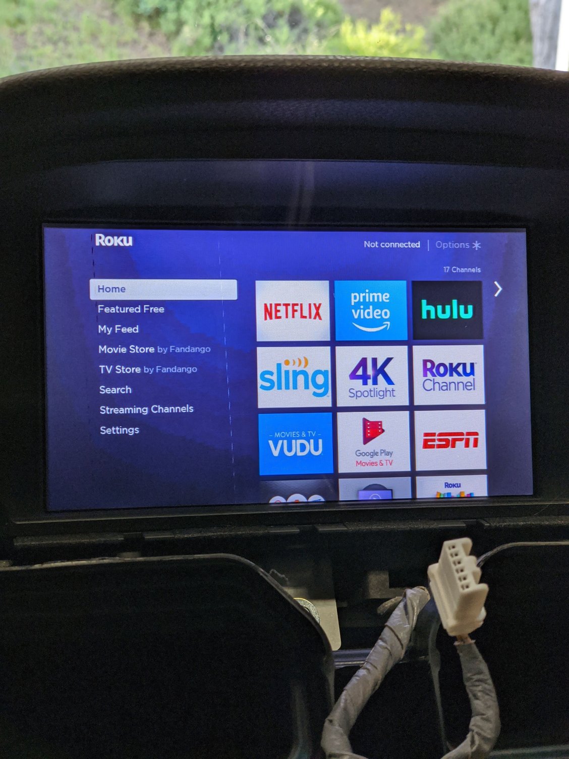

For my setup I have a Roku stick (which keeps losing it's setting because it doesn't have constant power so I'm switching over to a Firestick when it arrives). Since I already have dashcams installed, I already have a fuse tap installed so I was able to buy a dual USB port power plug to power my Roku stick. I also ran a USB A to micro that runs through the cabin filter opening so I can update the Navtool without having to take everything apart.
Overall Android Auto seems to work, however the top of it is cutoff slightly (see picture). When I emailed the Navtool guy to see if there's a way to calibrate the display he basically said no, it's controlled by the car, which I find odd. I tried adjusting it inside Acura's diagnostic menu with negative results. I'm going to keep working at it to fix it.
