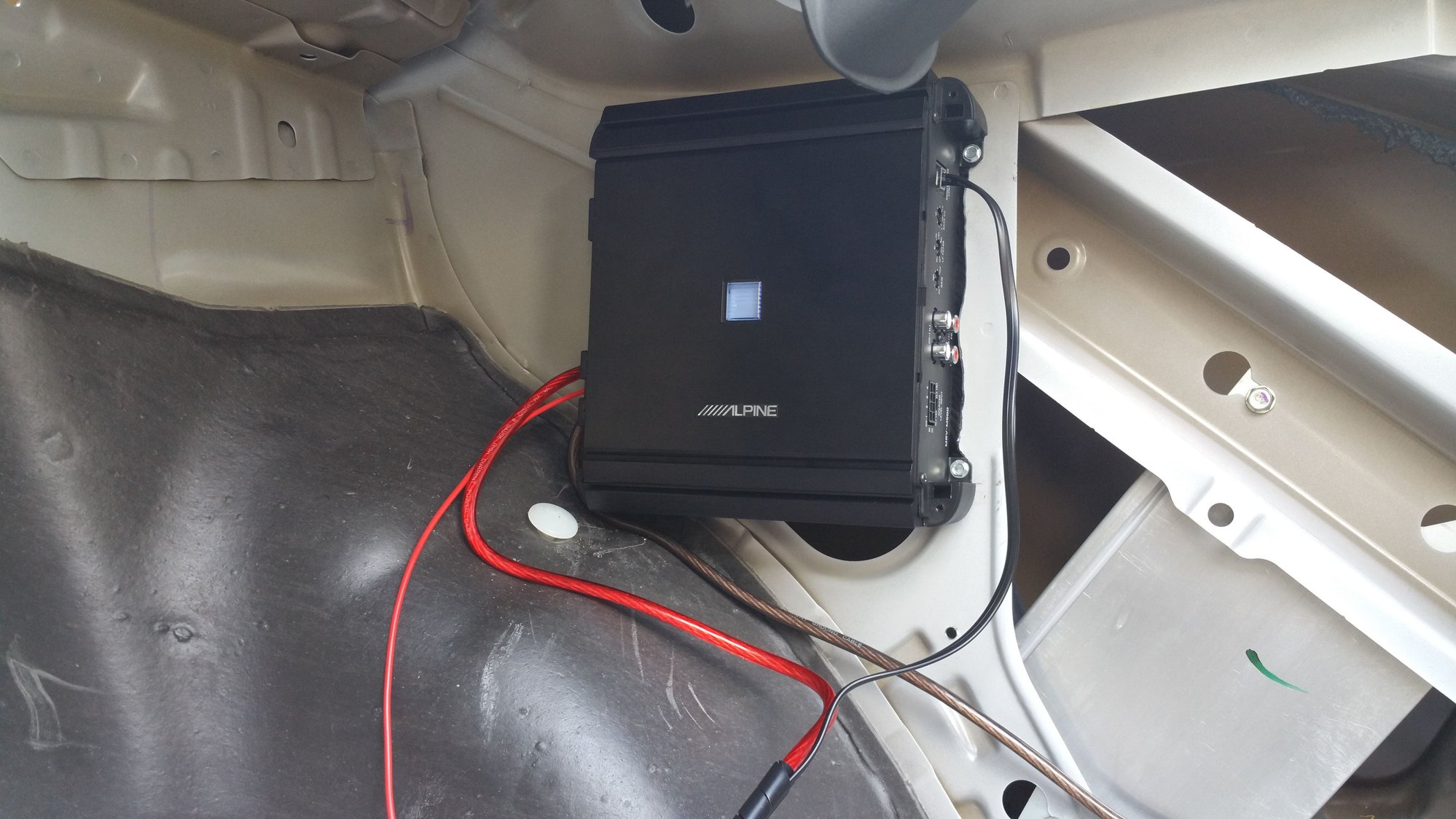

Hey all just tried something new and decided I wanted some more bass out of the stock system. Ordered a 8 inch type r from alpine, with a alpine 500 mono amp. I wanted a factory look so I will be hiding the amp. I also added additional sound damper.
So far this is what I have done.
Amp installed on the left side next to factory amp, fits perfect behind truck carpet.
Before
Ran the power wore thru the driver side fender per other post, but you can see any wires and ran it to the back thru molding and rear seat.
Still waiting on the subwoofer to come in the mail, should be all done my monday. I will be connecting the amp with a online converter with the amp power on built into online converter.

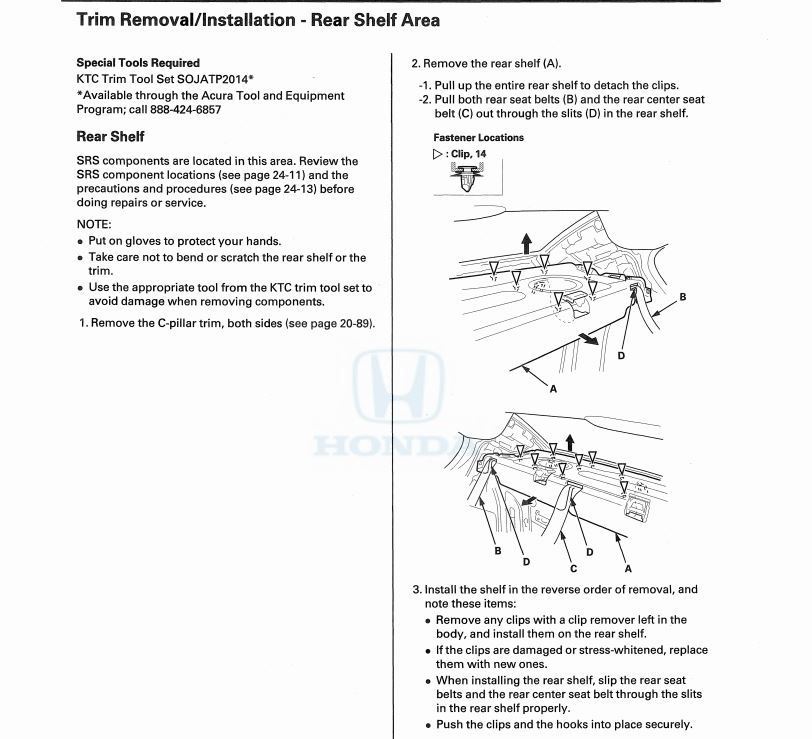

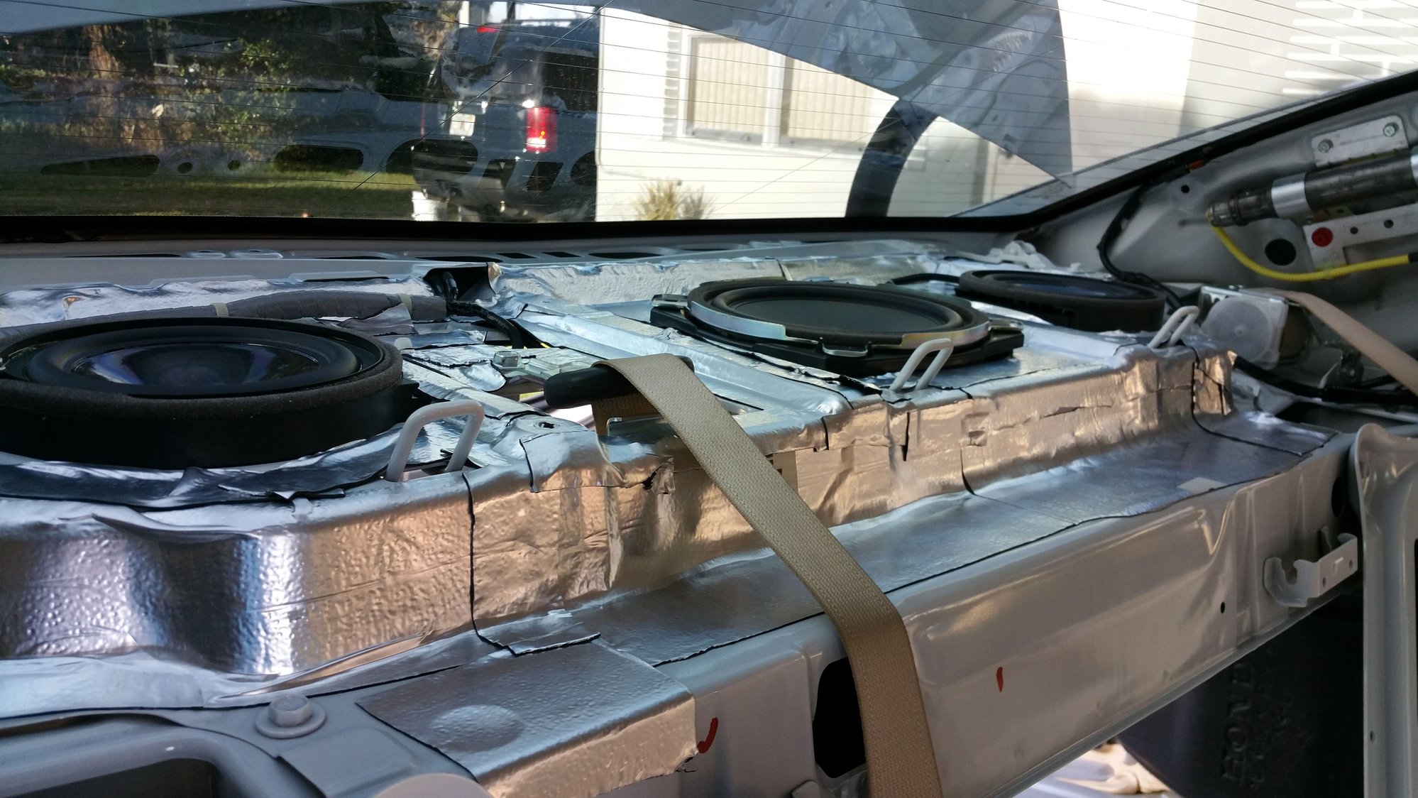

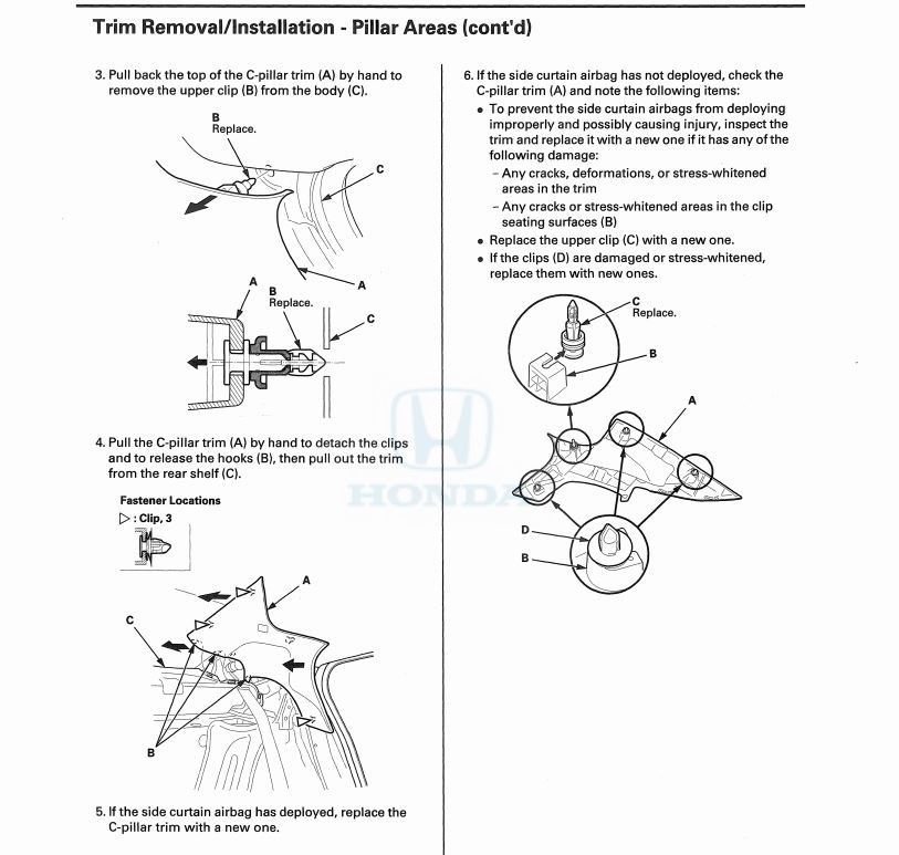

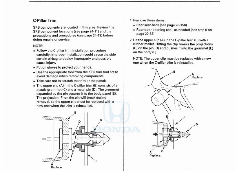

It's not hard to remove. You do need elbow grease. You have to remove the back seat first, then the trim in the corners. The back dash pops out pulling up.
The back seat cushion is held in by clips right under where you would sit on both sides. Push down on the seat then pull the release. I think a few 10mm holds in the back . I dynamatted my back dash and doors too I can say it helps out some.
Old Jan 30, 2015 | 08:37 AM
TheMuffinMan's Avatar
Joined: Jan 2015
Posts: 993
Likes: 211
From: Virginia
Any chance you can be slightly more detailed?
I knew when I bought the car someone had removed the rear speaker deck, but when I got the car tinted yesterday we noticed they didn't replace the rear deck correctly so the center part is buckled upwards - I'm guessing a clip is out of place.
