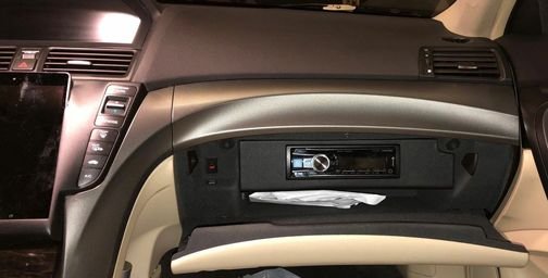

I custom fitted/installed an 8" tablet in my car with a Alpine digital media receiver in my glove compartment. I installed a steering wheel module to keep my steering wheel controls. I originally used my oem headunit behind my tablet (bluetooth connection) but then my factory amp crapped out on me. Here's a demo video I made.
Asus Tablet install
What did you install when the OEM Amp crapped out? One thing I'm making sure of is that the Bluetooth system is not the OEM one anymore, the sound quality is bad and there's a few seconds delay, preventing me from using Google Assistant.
I'm using an Alpine UTE-62bt. I'm rarely on my phone when I drive so I don't connect my phone to it. Just my tablet is connected.

Jtech316, it would be very cool and helpful if you posted what you did to make your install happen. I like it. But I would assume many of us would want to know how you did it.
