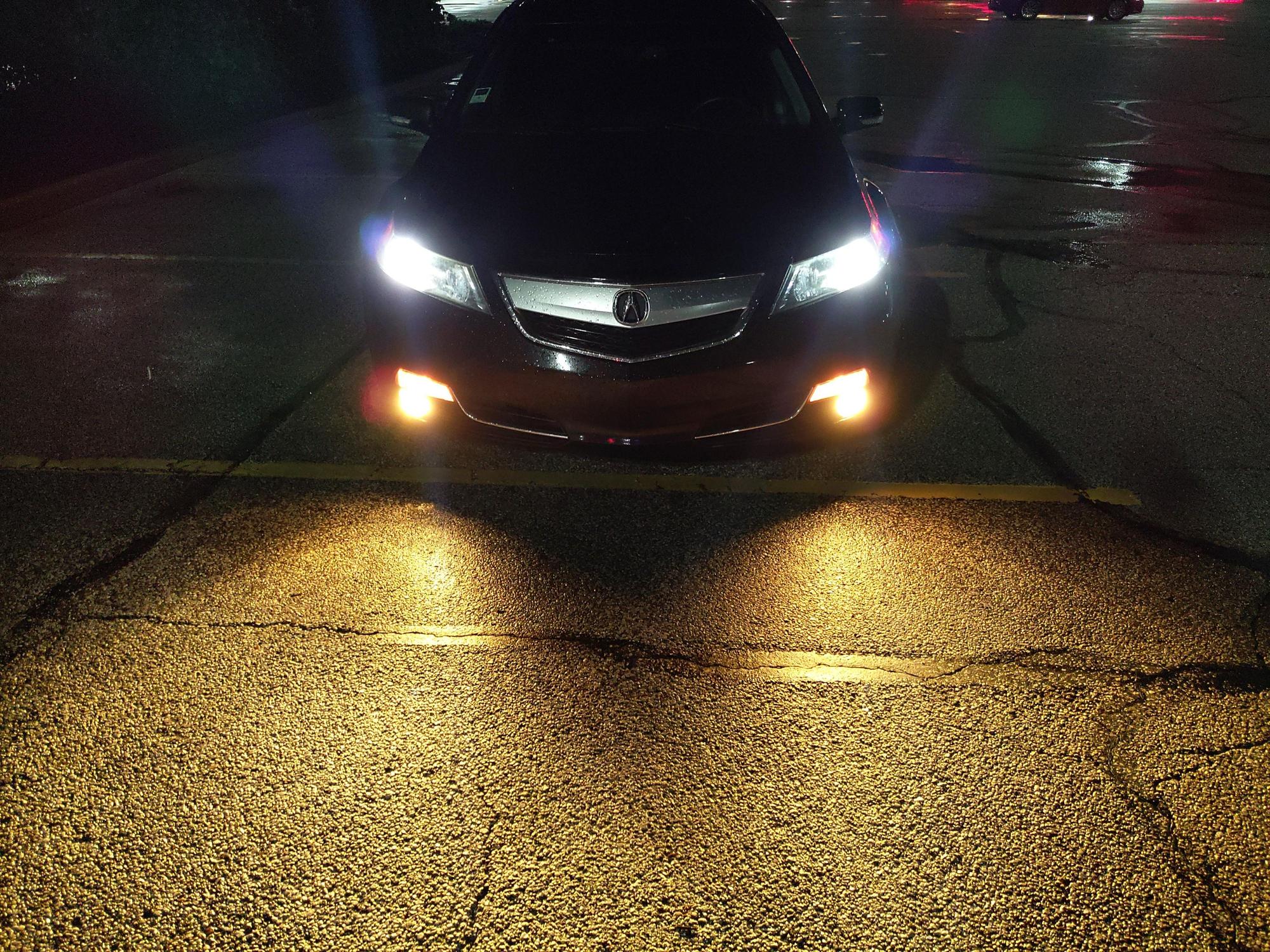

I have a picture from the other night when the driver's side turned pink. I'll post that now, and tonight I'll post the look with the new bulbs.
Old May 21, 2022 | 11:50 PM
Ascension's Avatar
Joined: Mar 2021
Posts: 891
Likes: 211
From: OH
So, the DRL is still off. I'll just have to live with it for now. Here is a picture of the new lighting situation:
