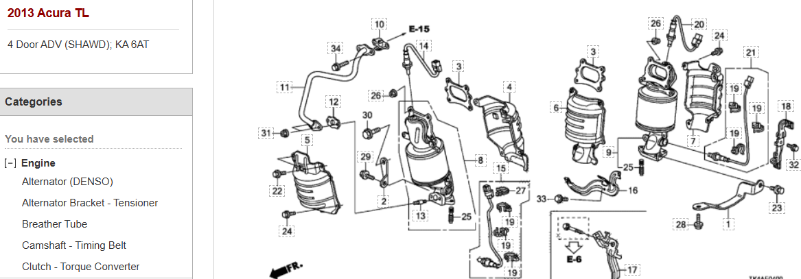

Just curious, at $1000-$1500 to fix, which heat shield(s) below was / were causing the problem (#3; 4; 17; 18; 19)??
Acura said it was the one closest to the firewall, but they took another one off and there’s no more sound. I’m not sure which one they removed.
Old Sep 30, 2024 | 06:10 PM
Posts: 6,852
Likes: 2,196
Probably #6 and / or #7.
#4 & #5 are up front near the radiator.
Retail price for those two possibly removed totals $72.27 and they wanted 1000-1500 to fix, lol.
