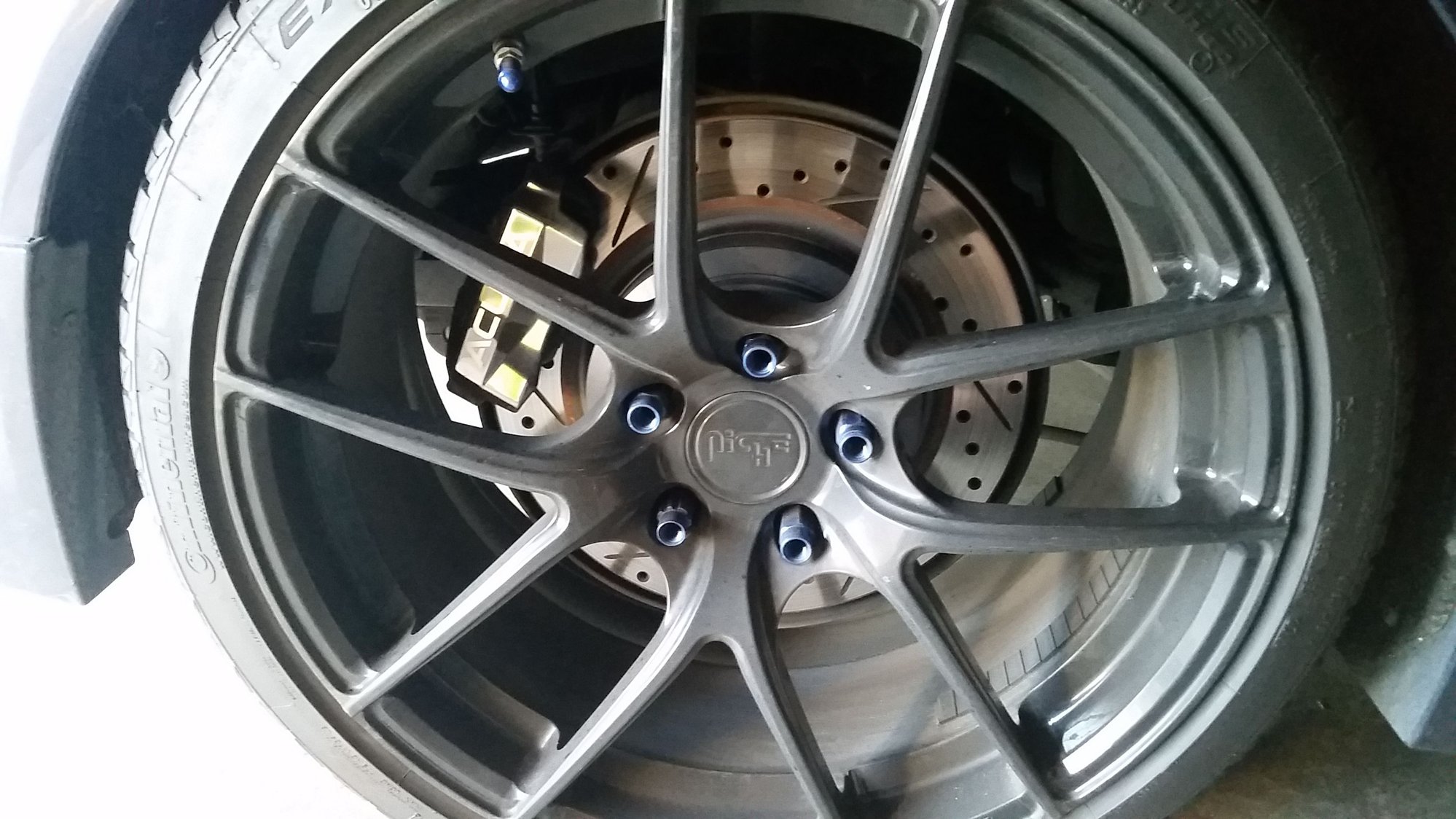

Old May 14, 2015 | 09:43 PM
pleepleus's Avatar
6th Gear
Joined: Feb 2013
Posts: 6
I have the slot/drilled combo package from excelerate. Works great so far.
Old May 15, 2015 | 11:11 AM
ExcelerateRep's Avatar
Former Sponsor
Joined: May 2010
Posts: 2,228
Likes: 354
From: Branford, CT
Looks awesome!
How did you manage to mount decals on your factory calipers?
That looks like maybe they're the RDX covers for the front?

Old May 20, 2015 | 11:22 PM
pleepleus's Avatar
6th Gear
Joined: Feb 2013
Posts: 6
yeah rdx covers on both fronts and rears.

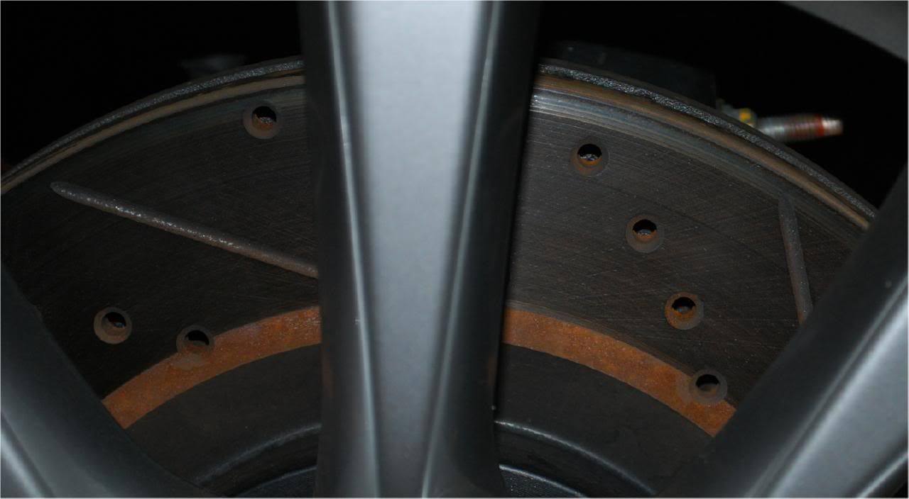

Originally Posted by ExcelerateRep
The black E-coating is the black coating you see on the standard Stoptech hubs and vanes. These are present on all their 1-piece rotors. The zinc coating is used on the 2-piece big brake kit rotors to protect against corrosion. It is available on StopTech AeroRotors and is particularly useful in winter climates where road salt and other environmental factors may increase the likelihood of oxidation.
So basically the zinc coated ones are coated all over and the e-coated ones are localized to the hubs and vanes only?
Old May 22, 2015 | 10:13 AM
Former Sponsor
Joined: May 2010
Posts: 2,228
Likes: 354
From: Branford, CT
Exactly. With a Zinc coated rotor, the whole rotor is coated so that 100% of where the pad does not touch is protected. With the regular black e-coating, most of the rotor is coated but there might be about 1-2mm between where the pad ends and the e-coating starts that gets that yellowish color. The gap varies by vehicle. Keep in mind even the zinc coating will eventually wear off.
It's not Stoptechs fault. All steel rotors corrode eventually. If you reeeaallly want to avoid corrosion I think ceramic rotors are the only solution, but they're way more $$.
