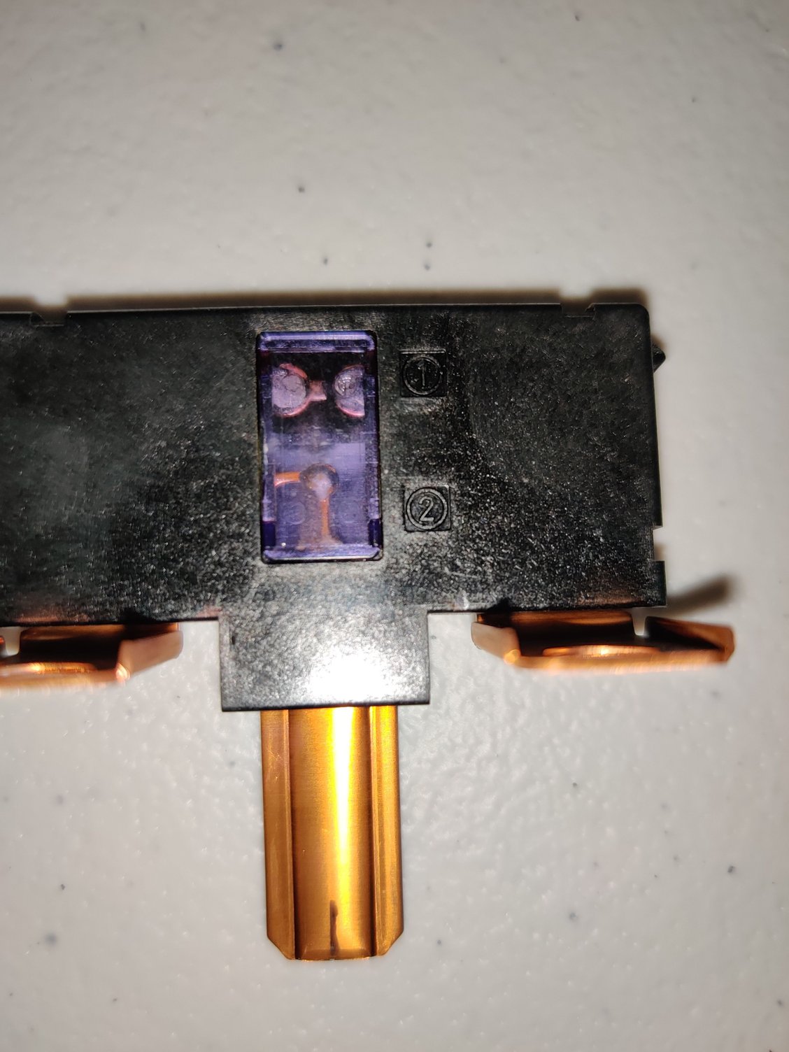

Just finished doing that and all wires look good. Now, this is the 4th gen.. Now when we tried to jump-start the car we made a mistake at first and placed the wrong cables on positive and negative. Since the car has no power whatsoever I think we just might be a blown fuse. Just checked the fuse box on the engine bay and the battery fuse seems is blown. Just took a picture added below.
Upper part seems not connected.

Regarding the 3G or 4G - battery cable are battery cables, so figured it made sense to rule to out.
Hard to tell from the picture but it does make sense in that seemingly no power is getting to the dashboard or anything else.
I will be picking up the new part shortly at the closest HONDA dealer hopefully problem will be solved.

And not to overstate the obvious, bring that fuse with you for X-referencing and perhaps you can ask them to confirm that it is in fact blown.
Oh yeah! But I think I just confirmed it with this video...
Thanks for the tip tho.

Sounds good and you even have the replacement part number # as well. Not sure if it matters, but if it were me replacing the fuse, I would disconnect my brand new battery first, then replace the fuse, then reconnect the battery - just so there is no juice flowing to the fuse anything down stream, but that's me.
Yeah the first step is to disconnect the battery then I pulled the fuse got the part number from that video and called the closest Honda dealer. They had 1 in stock so I ask to secure it I am just waiting for my ride to get it.

If you jump started the car with the power and ground cable in reverse, it is guaranteed that you have blown likely the main fuse and maybe some other small fuses. You need to check all the fuse boxes to make sure battery power can feed to the entire car.
Many years back, I made the same mistake when hooking up my Integra in pitch dark, and the main fuse and an accessory fuse were blown. I was lucky that my PCM computer as well as the other car did not get damaged.
Problem is solved now.. It was the main fuse in the engine bay. 27 bucks at the local Honda dealer. I checked everything on the car and all is working fine thank god.
