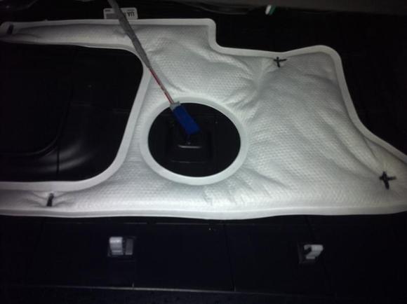

The drivers side seems easy - it's like taking out the panel to replace a fuse. There is a little 'handle' you can twist to release the it.
The passenger side doesn't have the same handle but has a deep handle in the back. How hard can you pull it? How do you remove the passegner panel easily without breaking it.
I am just going to drill a hole in front of the light in it to see if the wheel wells light up more at night time.

they are interior clips. pull them!

Thanks justnspace - I found these images. It seems like he took good ones of driver side but not of the passenger side. I can will attempt to pull it carefully.

its the same type of clip in passenger
you see the silver prongs ^ aaaaaaaaa^
they belong to notches, and you just pull the silver prongs out of the notch
