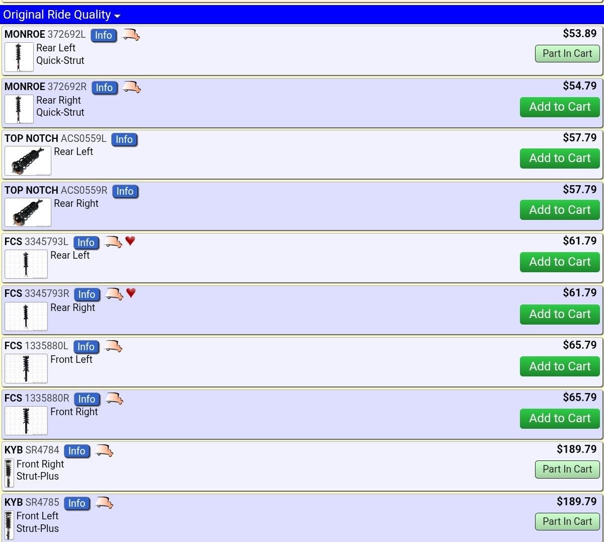

RockAuto - KYB - time to search

I read reviews online that FCS works well for Acura users. KYB is expensive. Maybe get what you pay for but.....anything new on the 125k miles should be improvement, right?
Old Jan 2, 2026 | 03:46 PM
EasyLoveRDX's Avatar
Joined: Dec 2020
Posts: 615
Likes: 154
From: Lowell MA
Monroe is junk. No experience with FCS or top notch, but given those prices I'd be very skeptical of the quality.

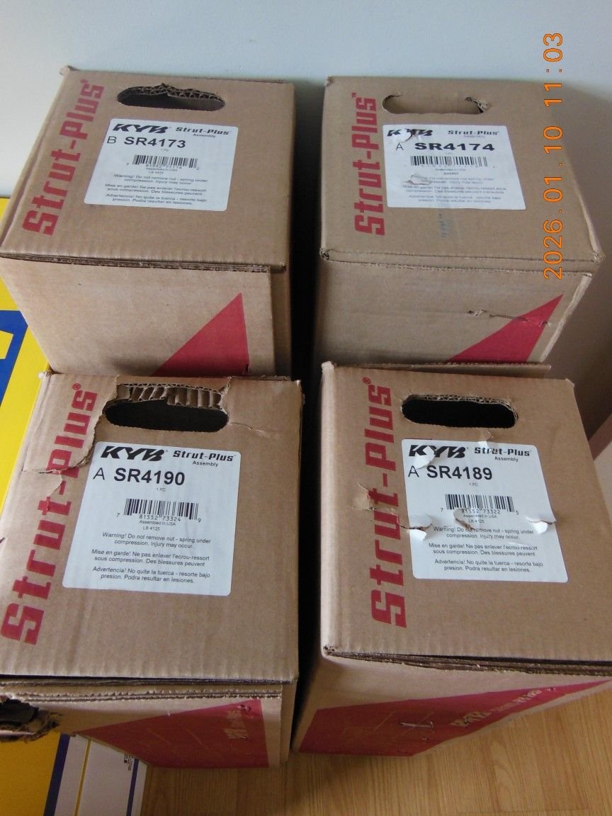

KYB is the most expensive because they are the best quality part. Just ordered four for my Accord rebuild. I also had KYB Excel-G struts (with stock springs) in my RDX before upgrading to the BC kit.
If anything, get the better parts for the front since that part of the car takes more abuse.
Maybe the roads are ok where you live, but in my area (New England) they're so bad that you basically need off-road suspension. This is partly why I'm such a snob when it comes to suspension parts quality - I've seen my share of busted ball joints and torn compliance bushings...

Personally , i would get KYB struts and swap over the stock springs myself (replacing bushings / boots/ top hats as required, but some people prefer to buy whole assemblies to do it all in one fell swoop.
You get what you pay for, I know folks like @csmeance swear by FCS assemblies, but I'm a KYB fan myself, When my struts fail, I will be purchasing KYB struts and DIYing it and save a nice chunk of change over OEM.
I would prefer KYB up front. Maybe FCS in the back. But FCS is $124 cheaper per - $248 more for front. Maybe a winning poker session will allow for the extra spend!!

FCS suck, my front bump stops were falling part quickly and the warranty process has been a hassle with them since I installed them myself and not through a shop.

Seems we're all in agreement about the superiority of KYB over the cheaper choices fwiw @Big Dom
Got these bad boys waiting to go 👀 buy once cry once...
