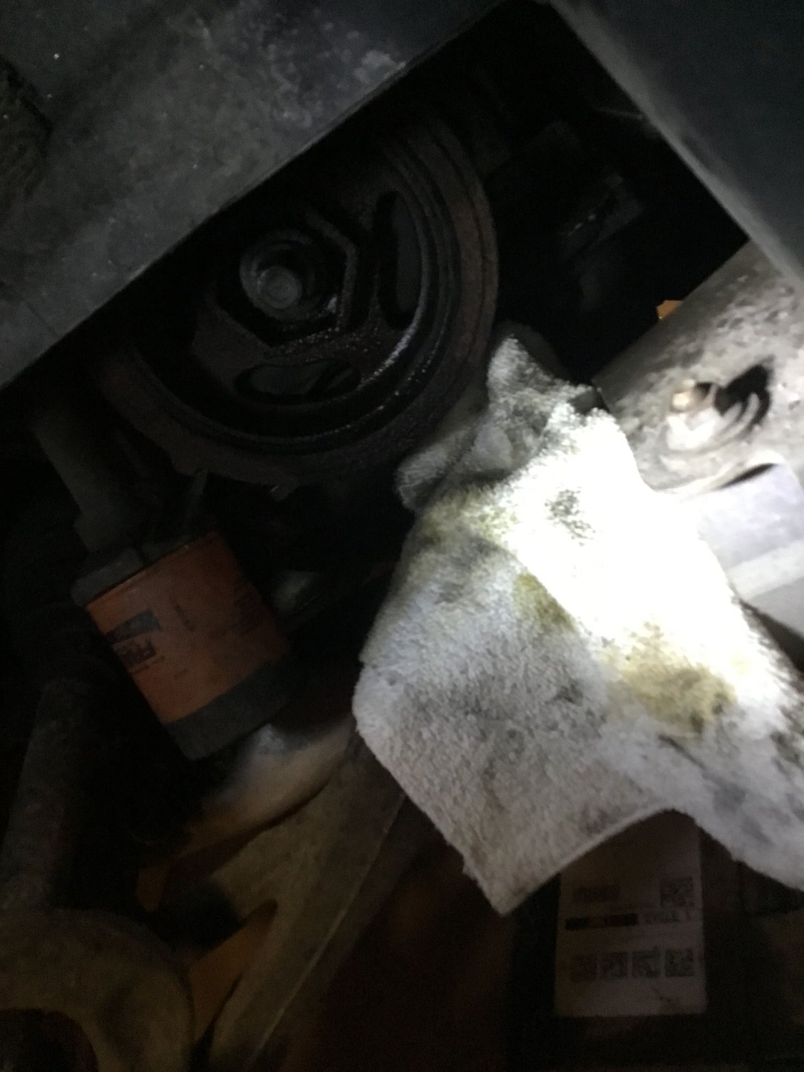

im replacing my timing belt and got everything apart except the crank bolt.
I tried everything to remove the bolt but it won’t budge..
I tried impact gun with heavy 19mm socket, torch the washer, put the breaker bar and turn the engine but nothing worked..
This is the crank bolt from hell..
what else can I do? so frustrated...

Dec 28, 2020 | 07:12 PM
keep trying...
use two breaker bars..one wedged against the floor and the subframe.
use the other breaker bar propped up against a jack stand and use long extensions.
I kept trying for a week and finally, I broke it free.

Dec 28, 2020 | 07:33 PM
A week? Wow.. that’s too much..
I used the breaker bar and lock it up under the control arm then turn the engine over.
The breaker bar almost lifts the driver side up but the freaking bolt won’t loose..

Dec 28, 2020 | 07:47 PM
You'll need a very strong impact gun to get them off, even with the fat/weighted sockets. Large pipe on a breaker bar and crank the engine is the backyard way. If you used heat, you'll need to buy a new pulley as the pulley has a rubber inner section that can split over time, and heating it accelerates the cracking/failure.

Dec 28, 2020 | 08:23 PM
Good idea with large pipe on breaker bar..
i’ll try That tomorrow.
Thanks..

Dec 29, 2020 | 01:07 AM
That impact wrench you have isn't gonna do it.. you're gonna need a legit pneumatic impact wrench or a high torque <insert brand here> one. I'm sure you'll be able to loosen it eventually with hand tools but it's gonna take some time and patience.
Are you located in the bay area by any chance?

Dec 29, 2020 | 06:49 AM
Quote: That impact wrench you have isn't gonna do it.. you're gonna need a legit pneumatic impact wrench or a high torque <insert brand here> one. I'm sure you'll be able to loosen it eventually with hand tools but it's gonna take some time and patience.
I soak it with PB plaster overnight and will try the large pipe on the breaker bar then turn the engine over today.
Unfortunately, I’m from Massachusetts way up north of the Bay Area...

Dec 29, 2020 | 09:18 AM
Might be able to rent a Honda Crank Pulley removal tool from your local auto parts store. I used this one from amazon and a harbor freight breaker bar.

Jan 5, 2021 | 12:10 AM
Handle off floor jack for breaker bar. Heavy duty ratchet strap.
Come-a-long to hook on front end of truck. Just like we used to get out of the woods on a rainy Friday night. Well same principle anyway. Just finished it up tonight.
Could not have done it without you guys. This was after taking to a local tire shop who could not budge it with their guns. Thanks again!
