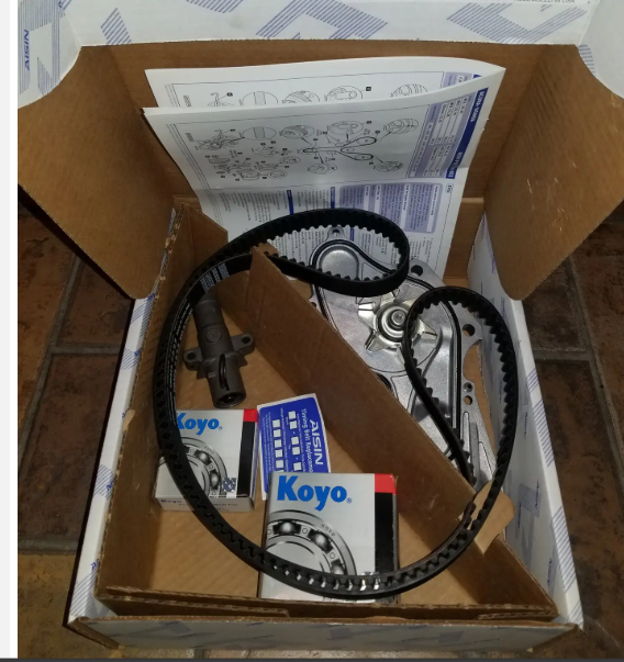

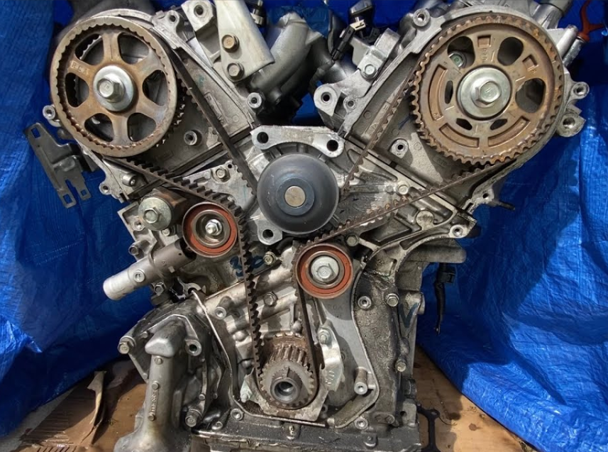

Secondly, even though the OP's 68K mileage is low the fact still remains that the timing belt components have been sitting in the position(s) below longer than being in use over 16 years?
A rubber timing belt and the bearings of the pullies & water pump are constantly 'tensioned' as shown below with heat & cold cycles as mentioned.
Take that comparison looking at the TB components while idly sitting in a box on a shelf.

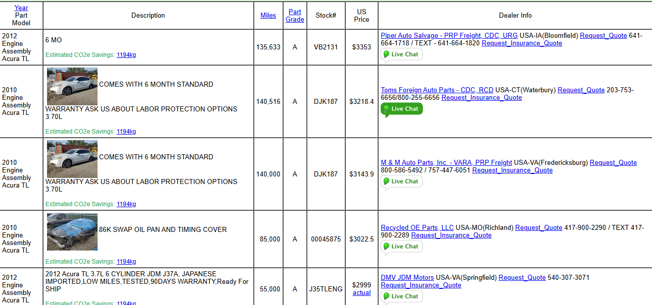

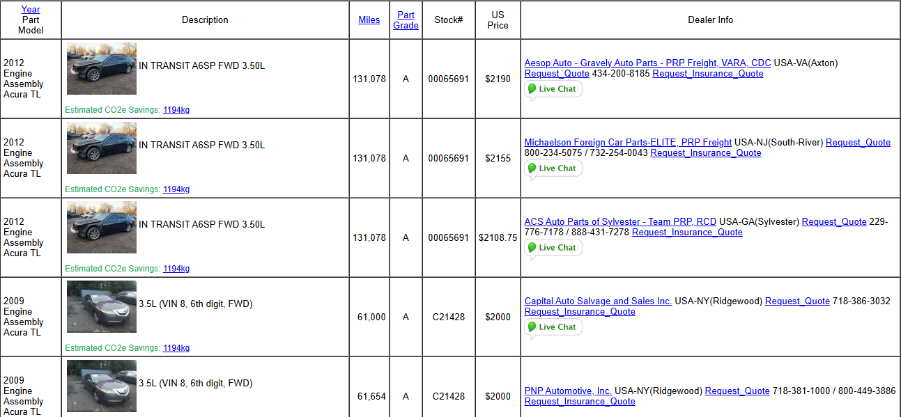

BTW, Since you don't indicate what engine you have in that pristine 68K mile TL of yours, I have included examples of both the 3.5L & 3.7L V6's below to give an idea of the cost of a 'new' used engine should yours sh!t the bed due to TB failure @ 16 years+.
3.5L:
3.7L:
. Enjoy!
