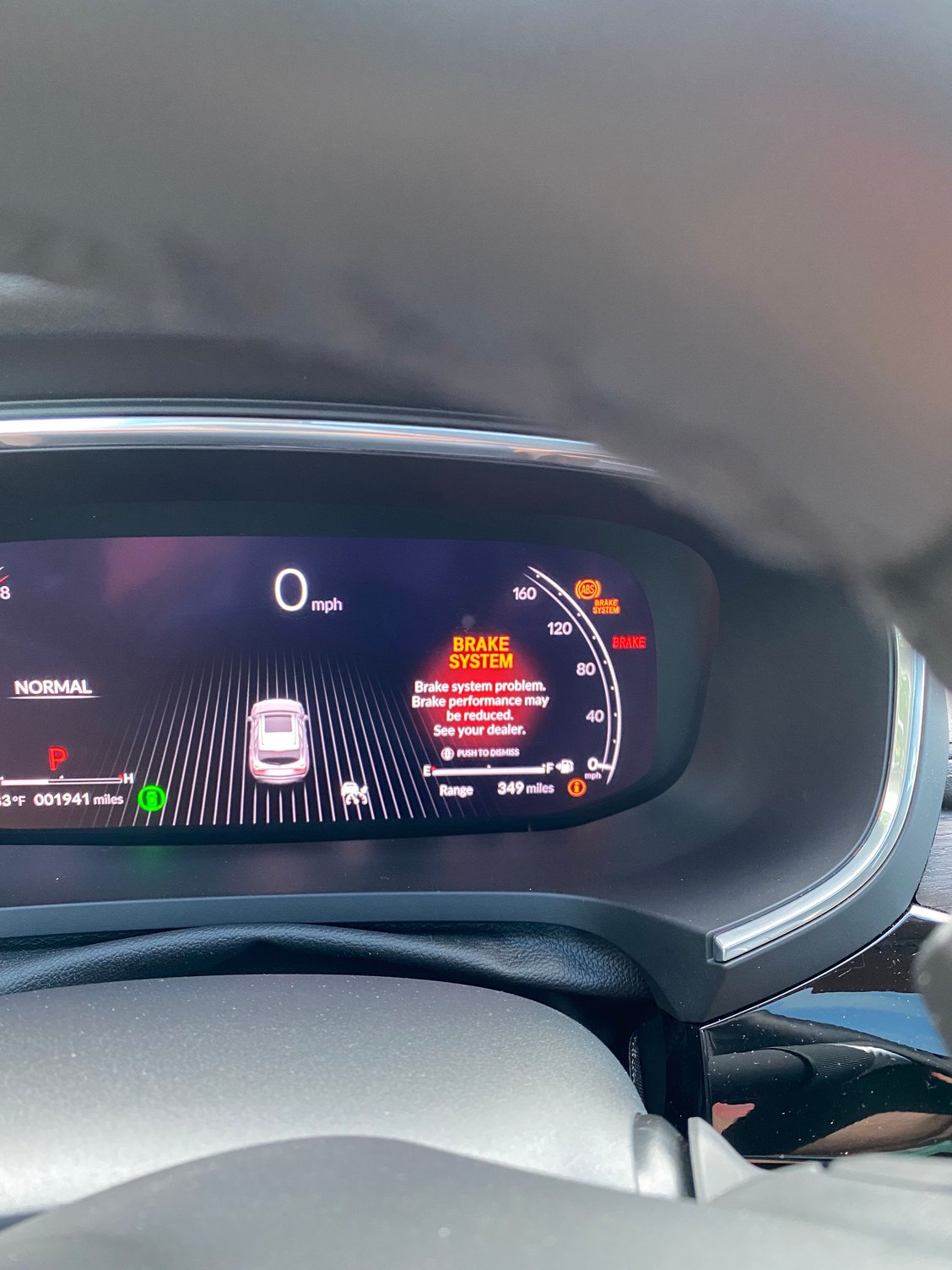

My brake fault alert was while I was parked and not moving. I took a pic, shut off the car and when I restarted it was cleared. Since then I have driven about 200 miles without a recurrence.
If the power steering assist went out while driving I’m certain that my wife would not be able to control the car. Let’s hope Acura can figure out what happened to your vehicle and then insure others are not at risk. This should be a top priority for them.

Just an update. Dealer still hasnt found anything amiss but wanted to keep car into this week for additional diagnosis. Due to the potential safety issues regarding a partial failure of the steering system, I filed a NHTSA complaint. My wife is terrified to drive her brand new car once it gets back.
Old May 3, 2022 | 05:44 AM
DSmith1178's Avatar
8th Gear
Joined: Feb 2022
Posts: 8
So dealer states the only issue they’ve found is a loose ground wire somewhere. According to them they spent alot of time on the phone with Honda North America working through all systems. Im skeptical but we are picking the car up today and I’ll keep this post updated if the issue resurfaces.
Old Jun 3, 2022 | 06:03 AM
DSmith1178's Avatar
8th Gear
Joined: Feb 2022
Posts: 8
One month update…..all has been good since the trip to the dealer. Either they fixed it with the loose ground wire or it just hasnt popped up again. Ill update if the problem arises again.
