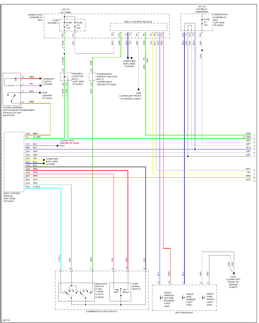

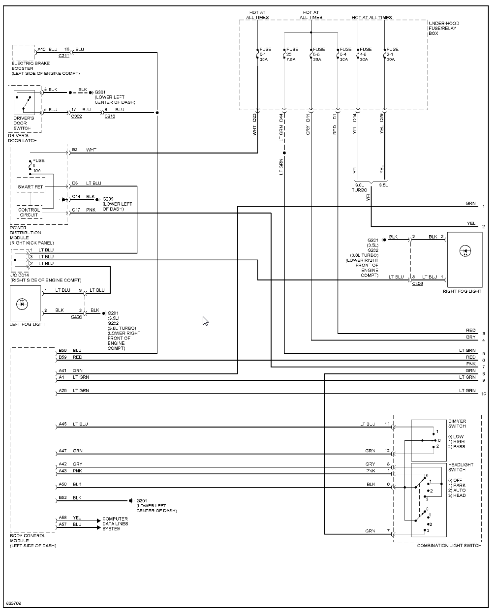

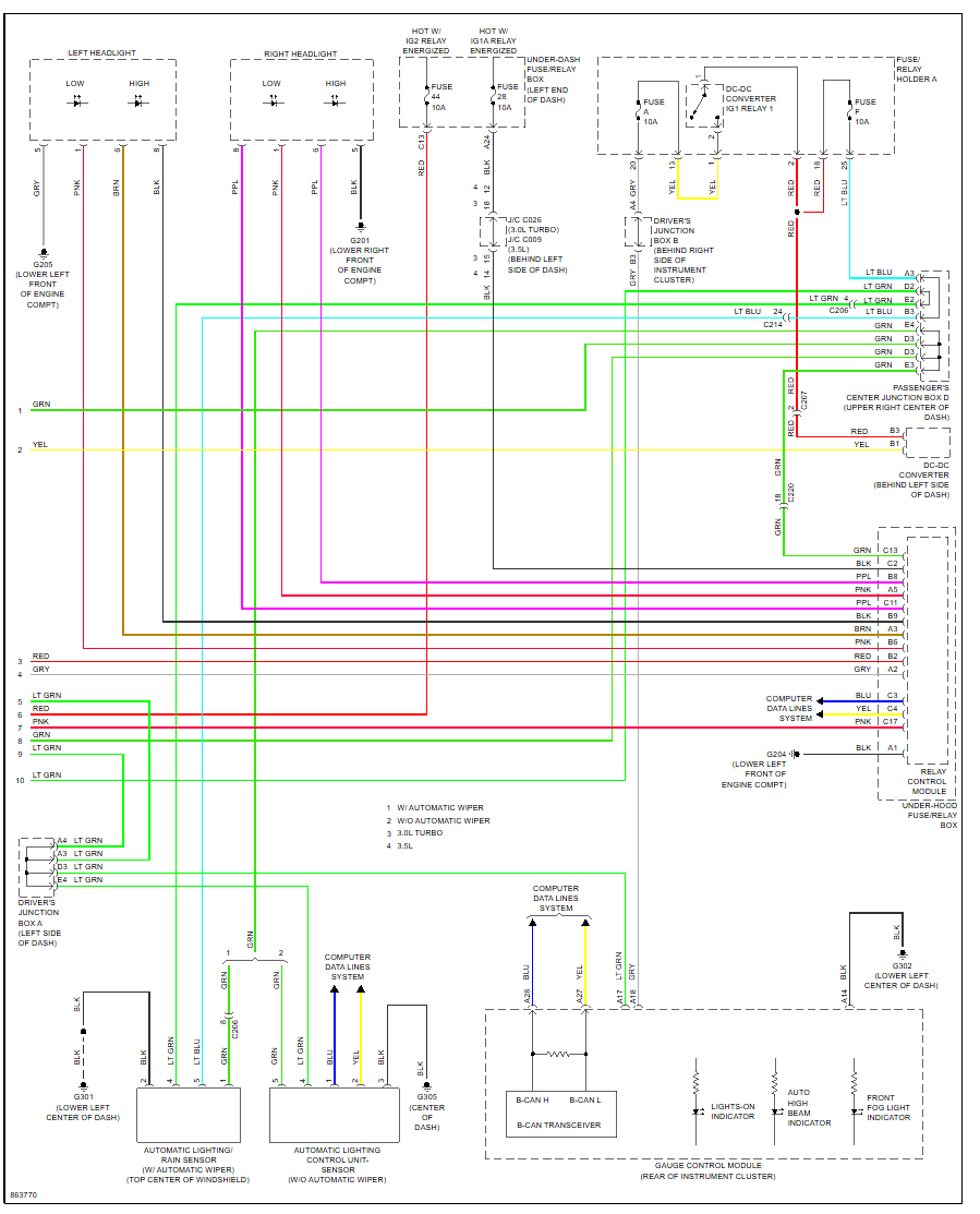

How’s it going everyone!

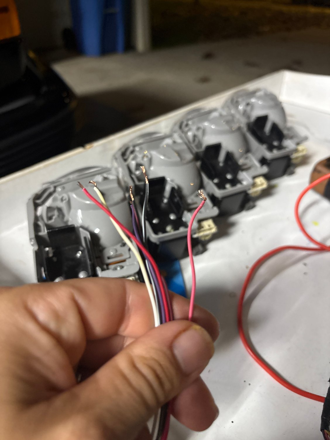

I am attempting to do a headlight mod that would force high beams and low beams to be on at the same time.
I have pulled apart a spare headlight I have but need to figure out which wires trigger the low beams and high beams. Should be fine pretty simple to add a two relays to make the function happen.
Any one have the wiring diagram available?

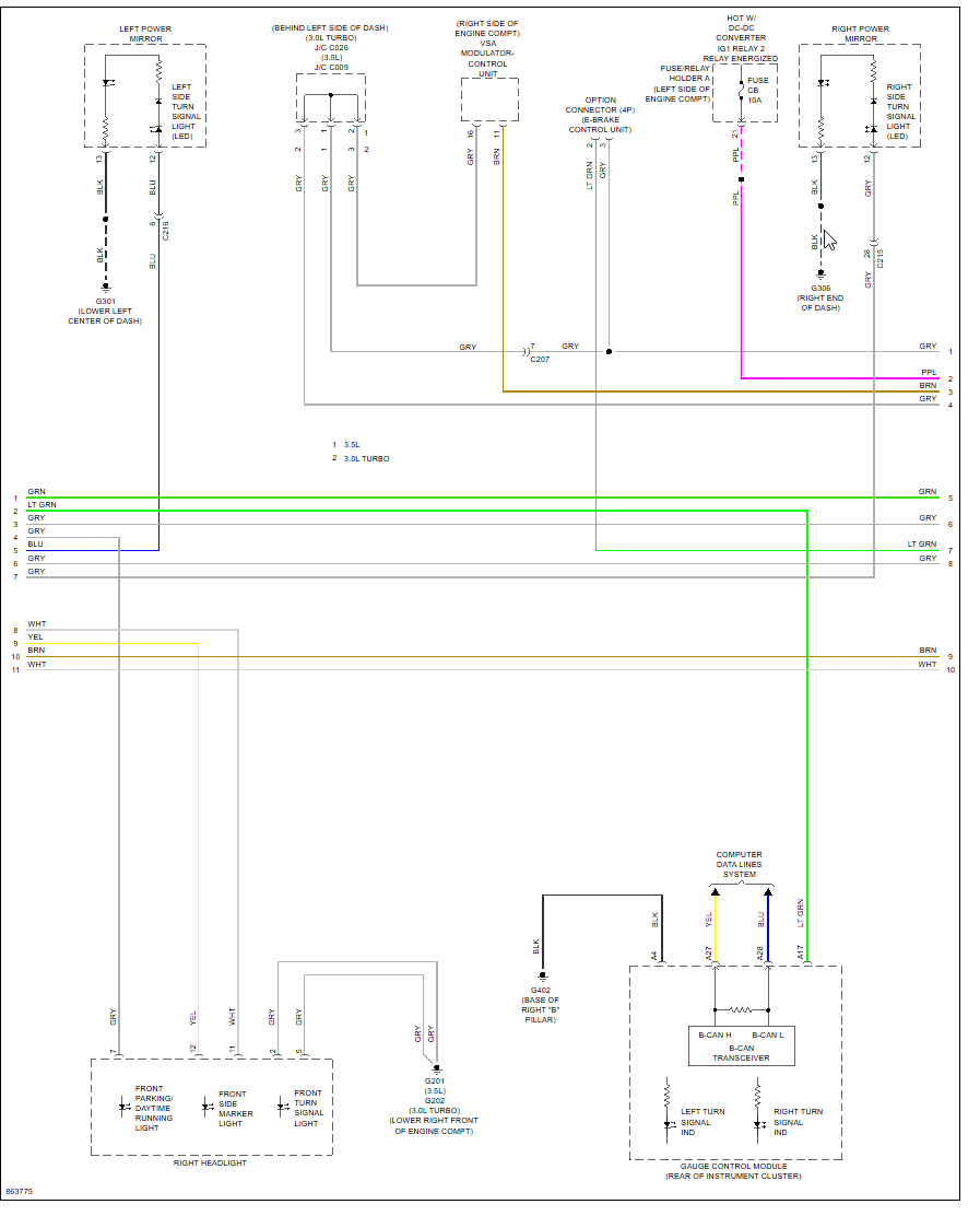

see if the attached helps
