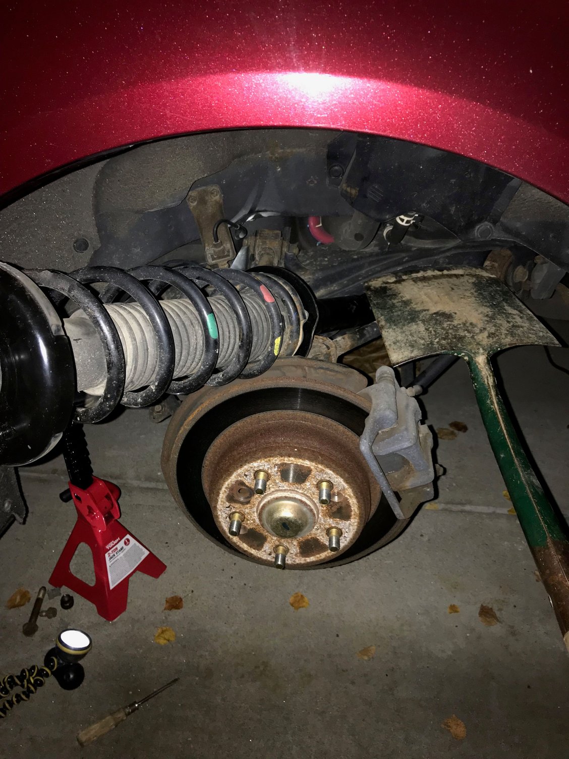

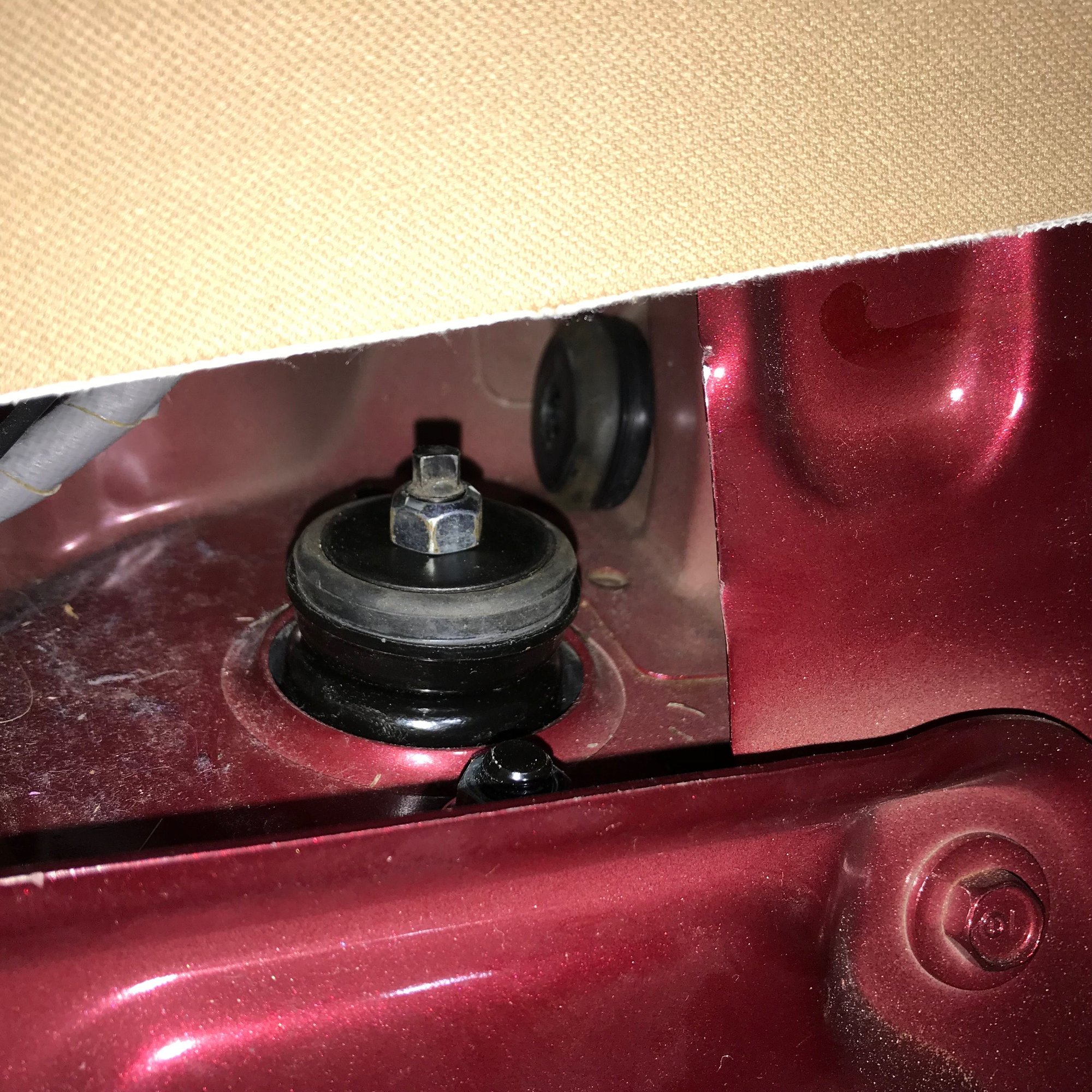

So I have not seen any good posts on how to replace TL 04 rear struts/shocks I have just done this using this as the primary resource but it misses some really important tips. As an infrequent member I can not create a new post so putting this here. If any experts are able to create a new channel/conversation I can move the content where it will be easier for members to find.
https://acurazine.com/how-tos/a/acur...reviews-423777
So first comment is to get the rear seats out you really do need a screwdriver or plastic lever to push the seat cusion out of the way on the lower bolts. Otherwise I found the socket kept slipping off the bolt.
As to removing the rear socks here are some tips I picked up from utube on hondas and my own experience.
1.What ever you do only release/undo the 2 mounting nuts under the parcel shelf.
Undo the bolt hidden by the bulkhead and one the other side of the rubber mount only
2. Remember when removing what I will call the lower pivot bolt to use a breaker bar and use gravity or your foot to assist. This means you will be working on the nut on one side of the vehicle and the bolt on the other.
3. To give your self more space loosen the break sensor cable and the plate that links to the sway link bar
This shows the plate with both the pivot and mounting bolt removed. Next unclip the sensor cable and push the whole plate down and out of the way.
4. You will need a lever bar to push the lower suspension down and take pressure off the pivot bolt. Even with the that you may need to use a punch to push the pin out and possibly a soft mallet to knock it out.
5. Once you have the whole unit free push the bottom in towards the centre of the vehicle and again use a pry bar to push the break assembly down to give you space to pivot the top of the strut out from the wheel arch. As you can see here I was using a garden shovel/space to provide leverage.
Removing unit using local garden pry tool!!
I will not comment on compressing spring and replacing as there are lots of posts and videos on how to do that. I will say that I managed this without air tools and a bit of patience. You will need a breaker bar and sockets though.
