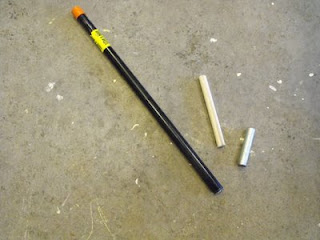

Those bolts torque to 125 lb-ft which is quite a bit. Once you're sure you've got the right bolt some PB Blaster/Liquid Wrench might help. Then a good breaker bar. Either a 20", like this:
Or, if that doesn't work, get a bit of pre-cut Black Iron Pipe at Lowes and put that over the breaker bar.

BTW: To break loose stubborn bolts, I lust remove the jack handle from the jack and slip it over the ratchet. Then I get everything positioned so I can push or pull the pipe handle while supporting against the chassis of the car. Sometimes you can angle the pipe so you can just step on the far end of it too. BTW: These calipers are known to destroy their threads when removing the bolt after many many years. If this happens, you will be getting a replacement caliper.

.... I lust remove the jack handle from the jack and slip it over the ratchet. ....
That's a great idea to make a long breaker bar.

lol. I've used my jack handle on everything from an 18" breaker bar to a tiny 1/4" drive ratchet to some even smaller open-ended wrenches. Whatever works to get nuts & bolts loose...
