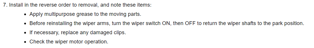

Hey everyone, my windshield wiper is stuck on the wiper mode on my 2007 Acura TL base Navi. I replaced the wiper motor but it’s still stuck in that position. Do I need it be recalibrated or something to have it go back to it normal position?

Pulled this from the service manual, hope it helps.

Thanks man! I’ll definitely give this a try this weekend.
