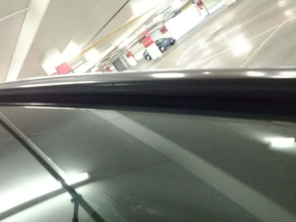

Ahhhh.. Just got my windshield replaced,bought AP unbranded glass,
picked it up from the shop at closing, got home and noticed this...
I called, they said they will fix it in 2 days.
but that its ok for me to drive.
what do you all think?
good advice or bad advice?
and what did they screw up?

that's the passenger side of the windshield.

looks like they either messed up the install completely OR they f-d up your drip molding. what does the other side look like? i'd have to look at mine a bit closer to see what's missing....brb.
looks like you are missing a piece of weather stripping of some sort on that side (the drip molding appears to be ok). your windshield sits with a "sunk" in look creating a gap (which obviously should not be there). i wouldn't drive it in the rain in case of leaks. i'd have the installer fix that ASAP. i personally would not necessarily feel safe driving around with my windshield like that.

that loos like one of the "clips" to keep the molding down, your windshield should be fine, they just didnt put the molding back on correctly.
the top windshield moldling "sinks" in if you look at the pic. it should sit flat, not sink. something is missing on his. the gap on my windshield is NOT that big and just under the drip molding there is a rubber piece that should be there and fill that gap to almost lift the glass a little to meet the drip molding.
his drop molding is flush with the A pillar as it's suppose to be. i wouldn't drive it like that.

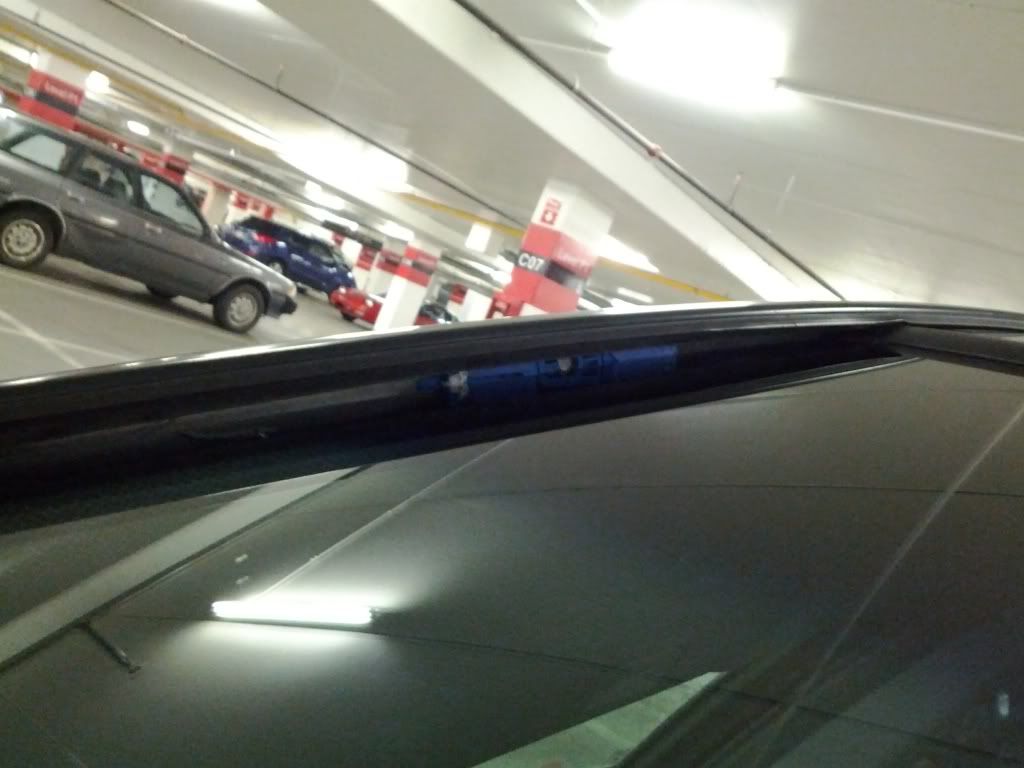

heres the drivers side
cant get to the shop till sat morning.
and ofcourse it rained last night ...and i dont have it covered...... aahhhhh...
I can hear a rattle on the passenger side.. FML

According to what I'm seeing on page 20-134 of the OEM shop manual, they've damaged/stripped off that part of the complete roof channel. That used to be an integral part that filled the gap between the roof channel and the window. To remove the roof channel, you need to pry between that rubber seal down into those blue clips. My guess is they damaged it and then sliced it off or something to that effect.
It's #13 73153-SEP-A01 MOLDING, R. DRIP SIDE USA 1 $110.23 $81.35

There is no specific trim "around" the windsheild. Only a trim piece across the top, the roof molding down the sides, and the cowl pieces across the bottom. The window is actually weather-sealed with a thick bead of glue when it's dropped into place.
If you look closely at the crossection on the right, you can see that the seal pressing against the window is an integral part of the roof molding trim (rain gutter). It's not a separate piece. In that cross section drawing, a 1mm thick blade is being inserted between the window and that seal to release the clips, so it looks a little confusing at 1st (at least it did to me).

final result
Turns out the trim was folded under itself.
Took a min to fix. Still.. Makes no sense to send it out not completed.
