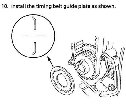

there is a spacer/guide that needs to go behind the crank, it's part no 13 in the link above for the harmonic balancer, make sure you put that back.
Old Dec 30, 2022 | 06:42 PM
Posts: 6,909
Likes: 2,211
And that it's on correctly:
