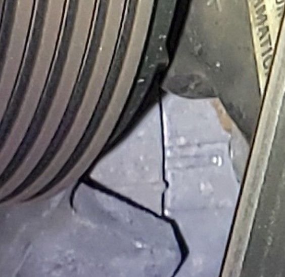

I found the cause, its the alternator pulley: Look inside the grooves how the metal is coming apart and bending:

Is that metal or just rubber deposits from the old belt? Is alternator spinning smoothly?

alternator is spinning smoothly. Upon closer inspection its rubber deposits from the old belt that has been melted onto the pulley, i just cleaned it, removed 95% of it. None of the other pulleys had this issue, possibly heat from the alternator caused this.

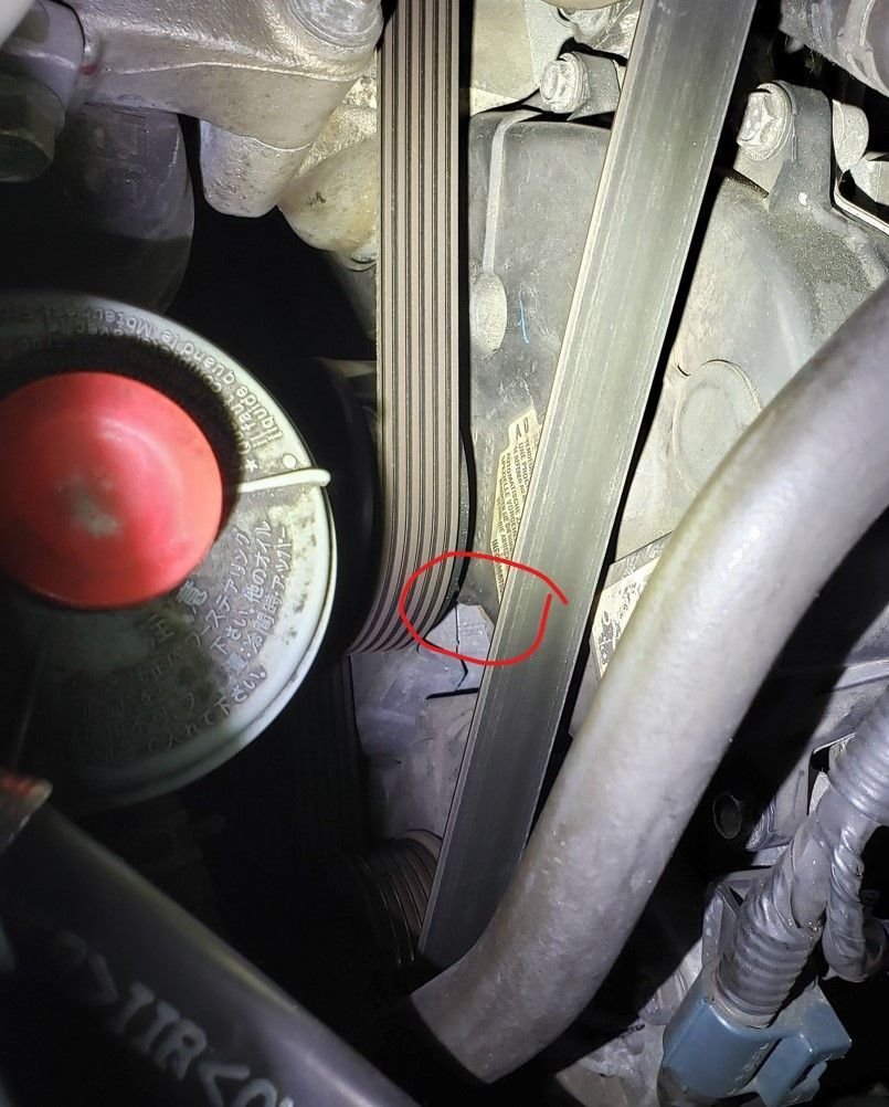

I also can't find the serpentine belt tension indicator. i don't want to remove the tensioner:
Serpentine belt tension indicator - AcuraZine - Acura Enthusiast Community
It is not easy to find. I attached an ebay picture that shows the items you want to see aligned. Hopefully it is a better picture than that in the thread you linked.
I am also attaching two pictures from my car that will show you where you want to look. Make sure you have a good flashlight.

I doubt the metal is coming apart on the alternator pulley, that is a steel pulley. Looks completely like serpentine belt rubber. You just need to change the serpentine belt.

I cleaned the pulley. It was rubber deposits. I changed the belt, problem solved.
