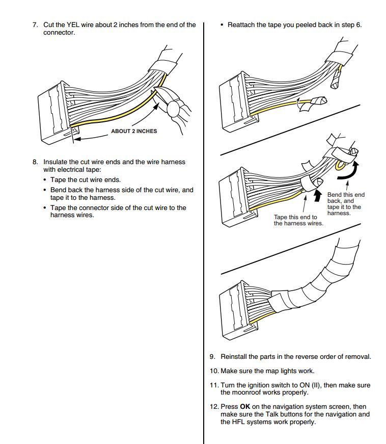

I'm chasing a similar issue, yours could be one of two things. This weekend I plan on opening my amp and preforming that fix.
First and easiest is the ground wire from the hands free link. There is a tsb that shows how to fix it, I can't find the link right now. If you dont use your HFL, I would remove the whole unit as it will likely soon start to kill your battery.
Next is its your amp, this link shows you how to fix it. Because it happens when its cold I assume this is your problem.

Here is the link to the TSB I speak of

Here is what that link to the tsb shows. I know it says when you use the HFL, however many other AZ members report the same wine/ buzz from their radio and this fixed it. It doesn't give a reason why it only does it while the car is running though. One of the two things I mentioned will most likely fix your issue, you have a little of both symptoms to the problems, buzz and only does it when its cold. I would start with the procedure below as it will take 20 min to do. If you youtube how to remove the hfl it shows you a faster way that you don't have to remove the map lights. If you have something small and wide you can just pry the whole unit out. They have you take the map lights out in the procedure below so you have something to grab on to to pull it off.
If this doesn't work either buy a new amp, open your current one, or move some place warm.
