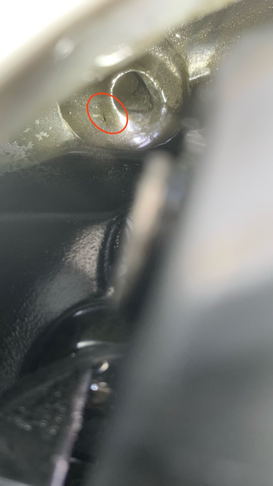

Yes it is the fuse box on the driver side left. So I removed the box and found the sunroof drain tube running right behind it. So I put a water hose on the low onto the front left sunroof drain hole and watched to see what happens. After about 15 minutes a bead of water ran down the outside of the drain tube. The fuse box sits up against that tube so that’s the culprit. I turned off the hose, inspected the sunroof well and found this.
I put 3 coats of flex seal on it and now waiting for it to cure before testing. Will update results.
