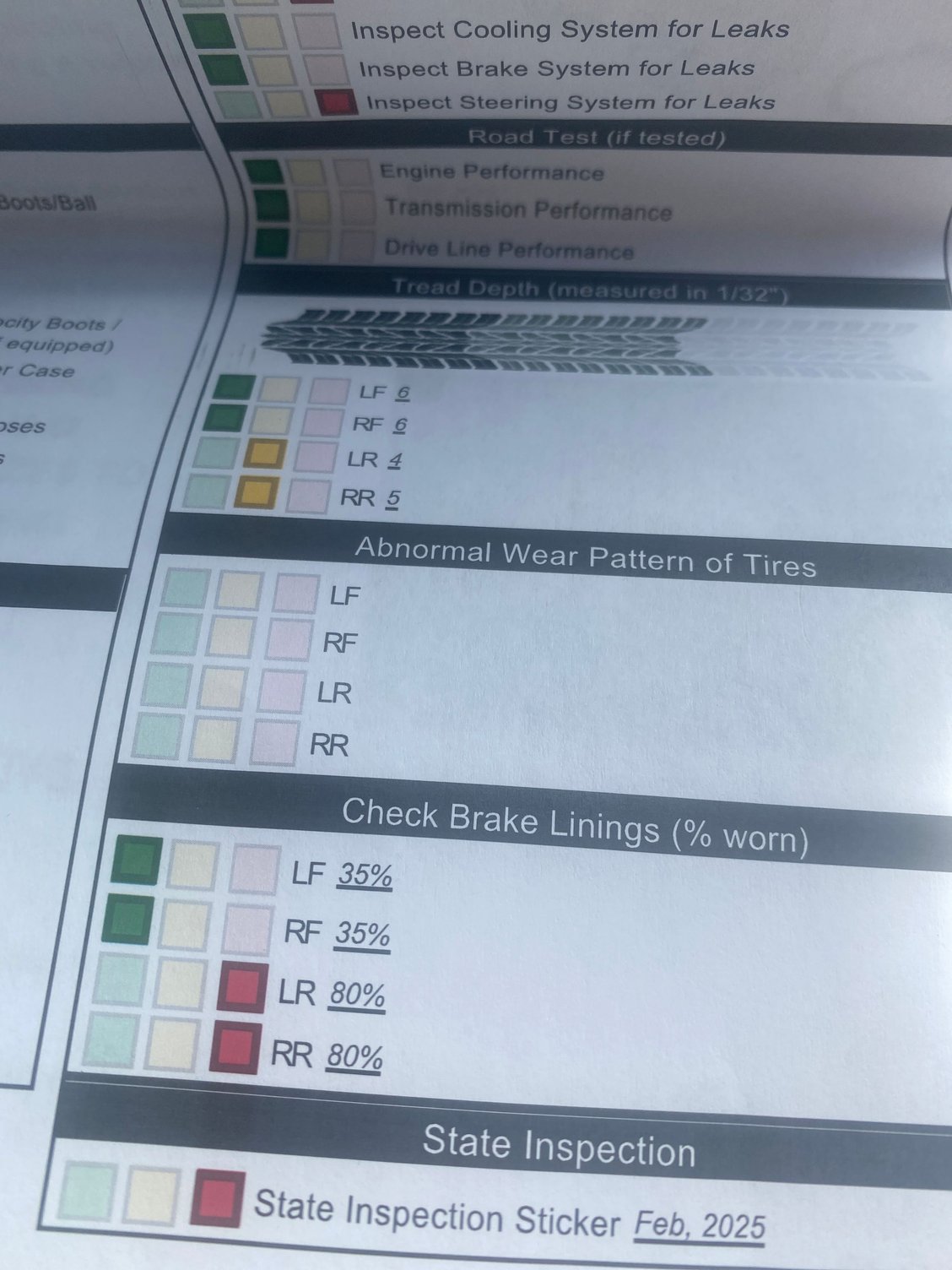

Dealer print out
Dealer print out

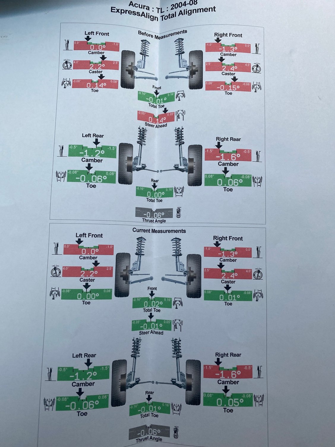

Yes I got an alignment a couple of days ago here’s the report

Stop replacing parts and start diagnosing first!
Do the rotation and see what happens. Report back and we would be happy to help. FYI - The alignment sheet you posted seems off (like really off) as there is a lot of camber in the rear, nearly +4 and -7 which is totally wrong. The total toe in the rear is near 0, but I think there is something else going on (sagging rear suspension or something else if these specs are accurate). Honestly it looks like they touched the front toe and nothing else which is a bad thing. They should adjust the front, rear, then go back to the front (changing the rear can change the front angles) until it's all in spec.
I think you might need to go to a new shop with this in hand and tell them what you've done and what the other shop has done and that you are really dissatisfied after spending all this money. Pay with a credit card! If the shop doesn't fix it, dispute the charges! If you don't care about going to the old shop, call you CC company and get them to dispute the charge for the money that was spent needlessly.
