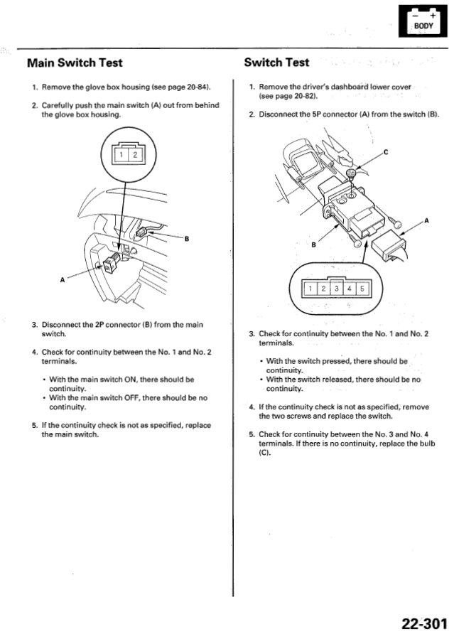

Took my car to get serviced and when I got back I noticed my trunk button in my car didn't work but my keyfob button did.
I checked the valet switch in the glove box and.. well there is no switch.
Do I need to order and install that part? If so is it easy and will it fix my problem? Or is there maybe a fuse or something that needs to be replaced. I honestly don't care if the switch is there or not, I just want the trunk button to work.
Old Feb 12, 2015 | 03:12 PM
polobunny's Avatar
Registered Bunny
Joined: Nov 2014
Posts: 8,307
Likes: 1,073
From: Montreal
Left side of page. Want to be cheap and not pay for a switch? Bridge 1 & 2 together using anything conductive.
Otherwise part number is 35810-SEP-A01, price under $10.
