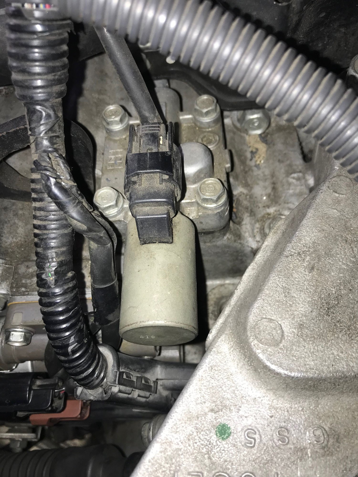

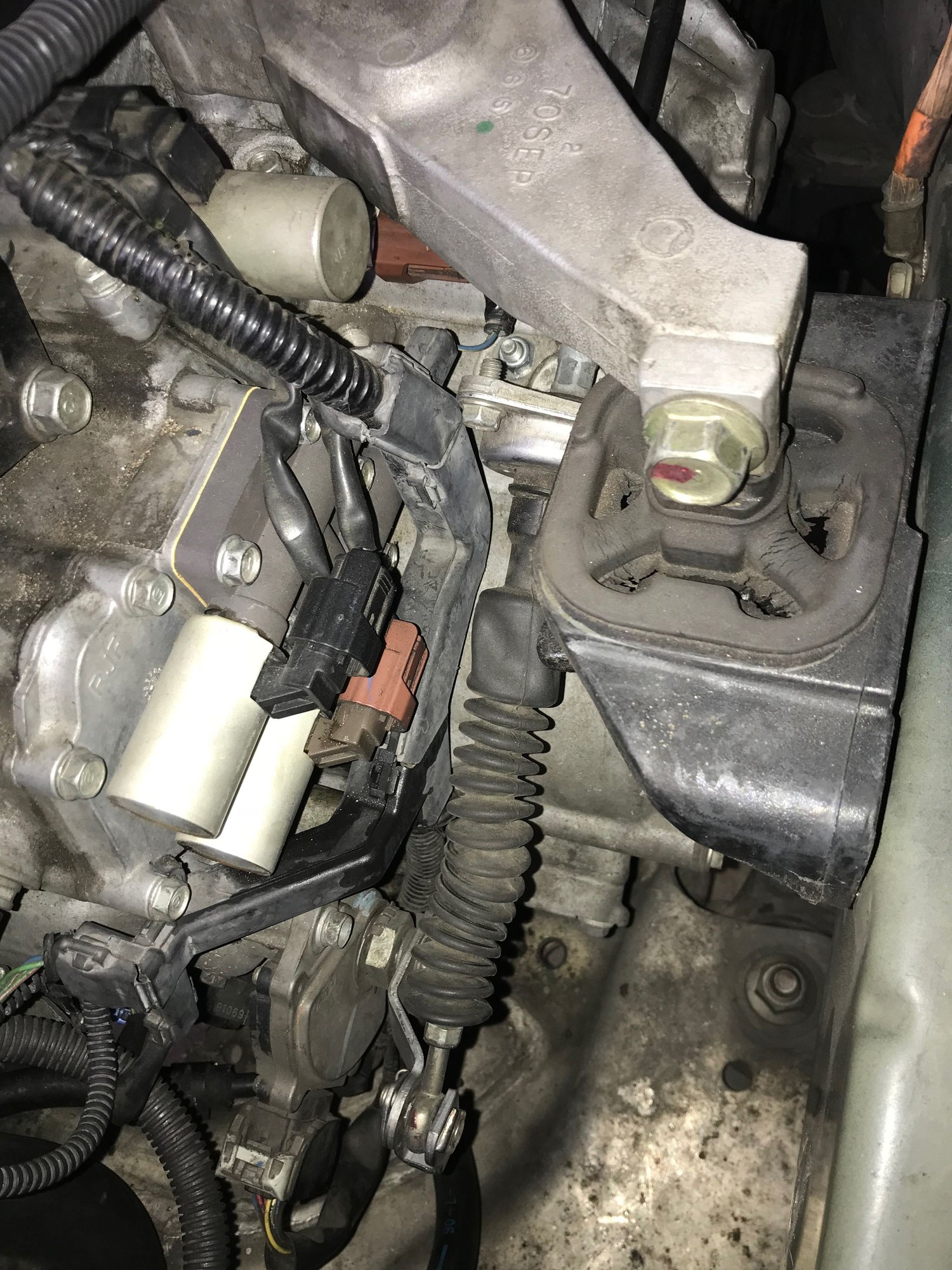

Sorry guys I was completely sidetracked by life's other issues to get back to you. Yes I've completed two full fluid changes throughout this issue and at the moment, believe I'm on the right track for a solution. I realized that I was only checking the dual linear solenoid
(28250-RDK-014)
on the side of the transmission and not the single linear solenoid
(28260-RDK-023)

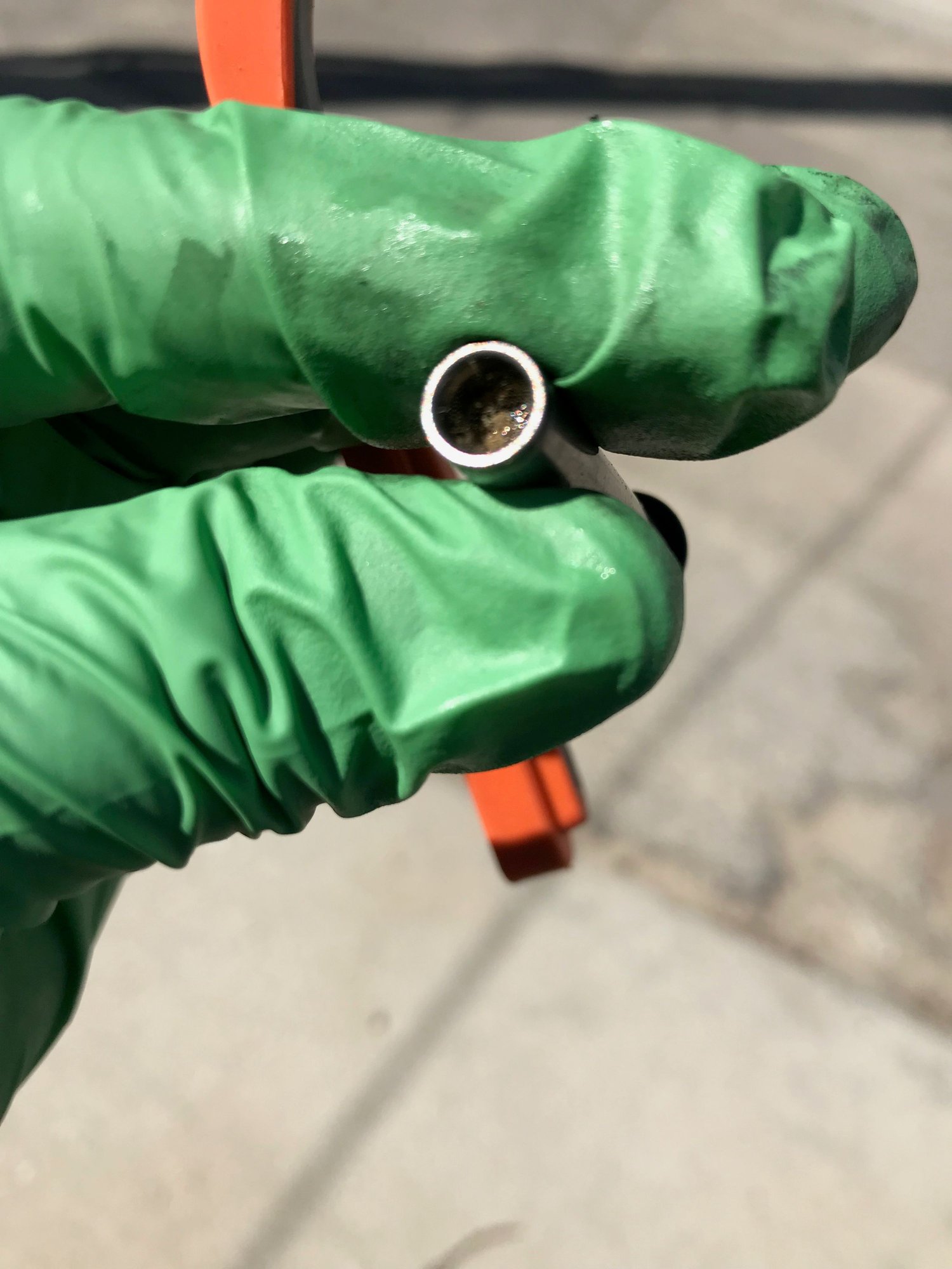

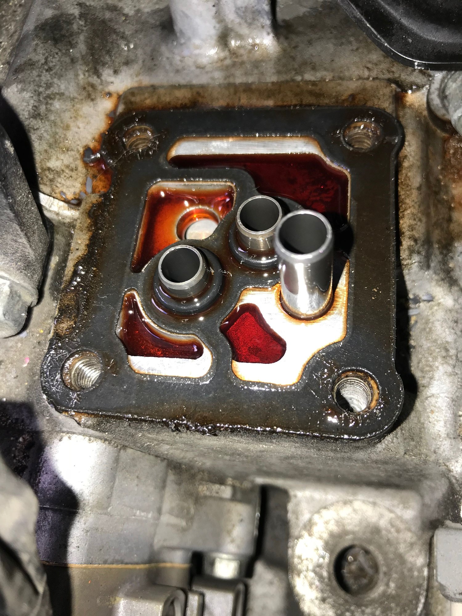

on the top. Upon inspection I noticed there was a 90% obstruction in one of the flow pipes
(22770-P7Z-000)
and was able to clear it. It worked! The transmission shifts normally again without any codes. I would recommend clearing these pipes in both linear solenoids to anyone in the future who has this type of problem. I attached pics of the mentioned parts involved.

This one didn't make the first upload.

Also, I realize the pipe itself was clogged, but were you able to run ATF through the solenoid itself to make sure there's no debris built up that could cause it from fully engaging in the future?
Old Oct 23, 2018 | 06:14 PM
Aleax's Avatar
Joined: Sep 2014
Posts: 33
From: Marina Del Rey, CA
No I didn't but that's a good idea. I had to order a new gasket and o-rings so I'll check that when i take it off again. Thank god its so easy to get to. I think I'd feel better if I checked the dual Solenoid as well but that's a bigger job and its less than a foot away.
