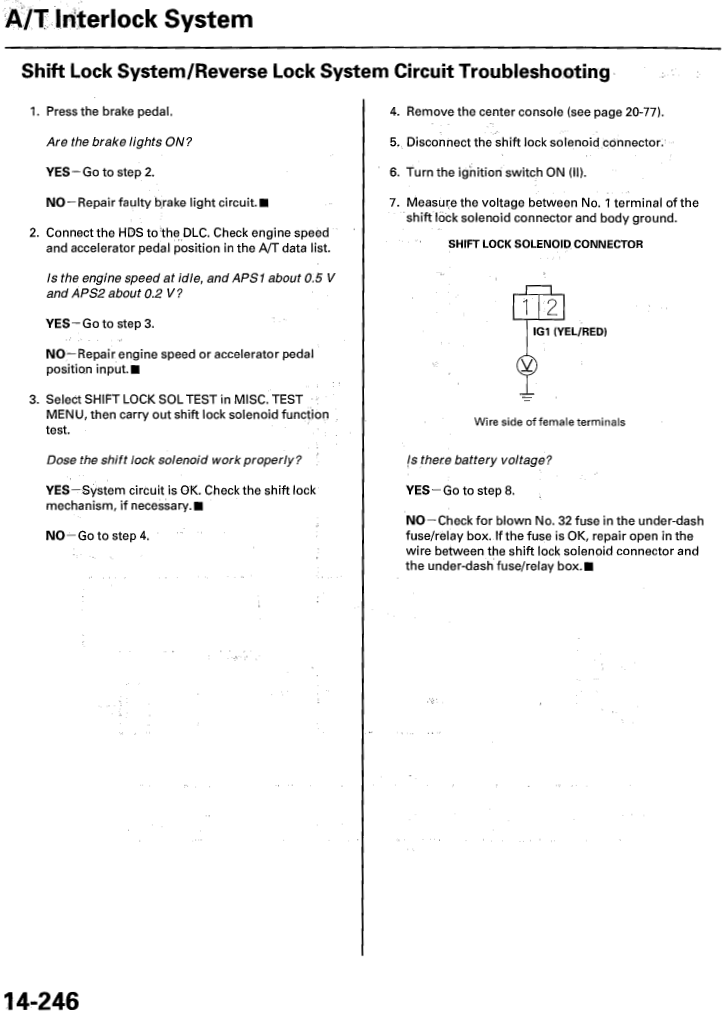

You can still use the car.
See the hole on the left?
That's the shift lock release. Pry the cover with a finger nail or a small screw driver covered with a cloth, insert your key in it and move your shifter to N. Remove the key then start the car.
Here's the troubleshooting steps for the shift lock solenoid.

Polobunny that is an excellent post. Pardon my ignorance but on Step 2 I don't know what an HDS and DLC is so I don't know what to do for that step. So if you could let me know what that is I would appreciate it.

Polo is all over this -
HDS = Honda Diagnostic System
DLC = Data Link Connector
Essentially this is asking you to connect Honda's Diagnostic system to the OBD port to read trouble codes.

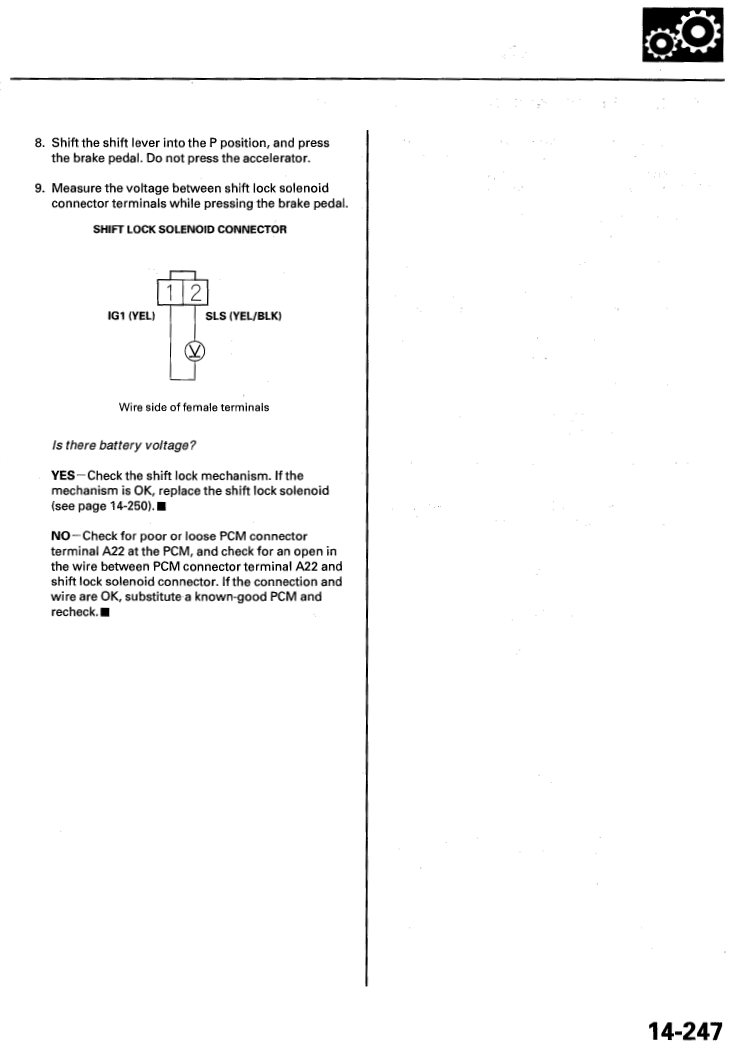

I would skip those HDS parts. Do as much diagnosing as you can without the part that necessitate special hardware/software. Most important steps are 1 then 4 to 9. Most likely shift lock solenoid isn't working, hence why I uploaded page 14-250.
Would you mind uploading the pages that show how to remove the centre console because I'm not quite sure how to do that.
