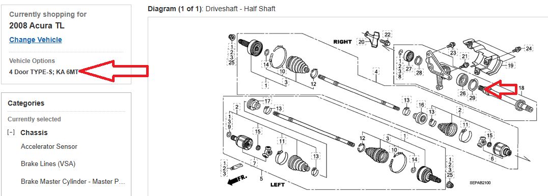

Old Apr 13, 2025 | 08:28 PM
Posts: 6,891
Likes: 2,206
Originally Posted by IAmMike
would the difference be, one is for automatic and one is for the LSD Manual gear box that only comes on Type S model
You are on the right track.
1) The OP has not posted on the forums since Feb 2014; therefore, you are likely not to get an answer.
2) As discussed previously above, the 07-08 base and type s have the same automatic transmission, as shown below.
3) I believe the 'difference', on the passenger side that the OP encountered during the axle installation on his Base model has to do with the #18 half shaft assembly below.
As you can see the part numbers for the half shafts are different between the automatic 07-08 Base/Type-S and Type-S 6MT's.
It appears the prior owner mistakenly installed a 29 spline Type-S manual transmission half-shaft assembly instead of a proper 27 spline half shaft assembly into his 2007 Base TL?
The passenger side inner female axle CV joint fits over the inner male half shaft end & not directly into the transmission housing itself.
